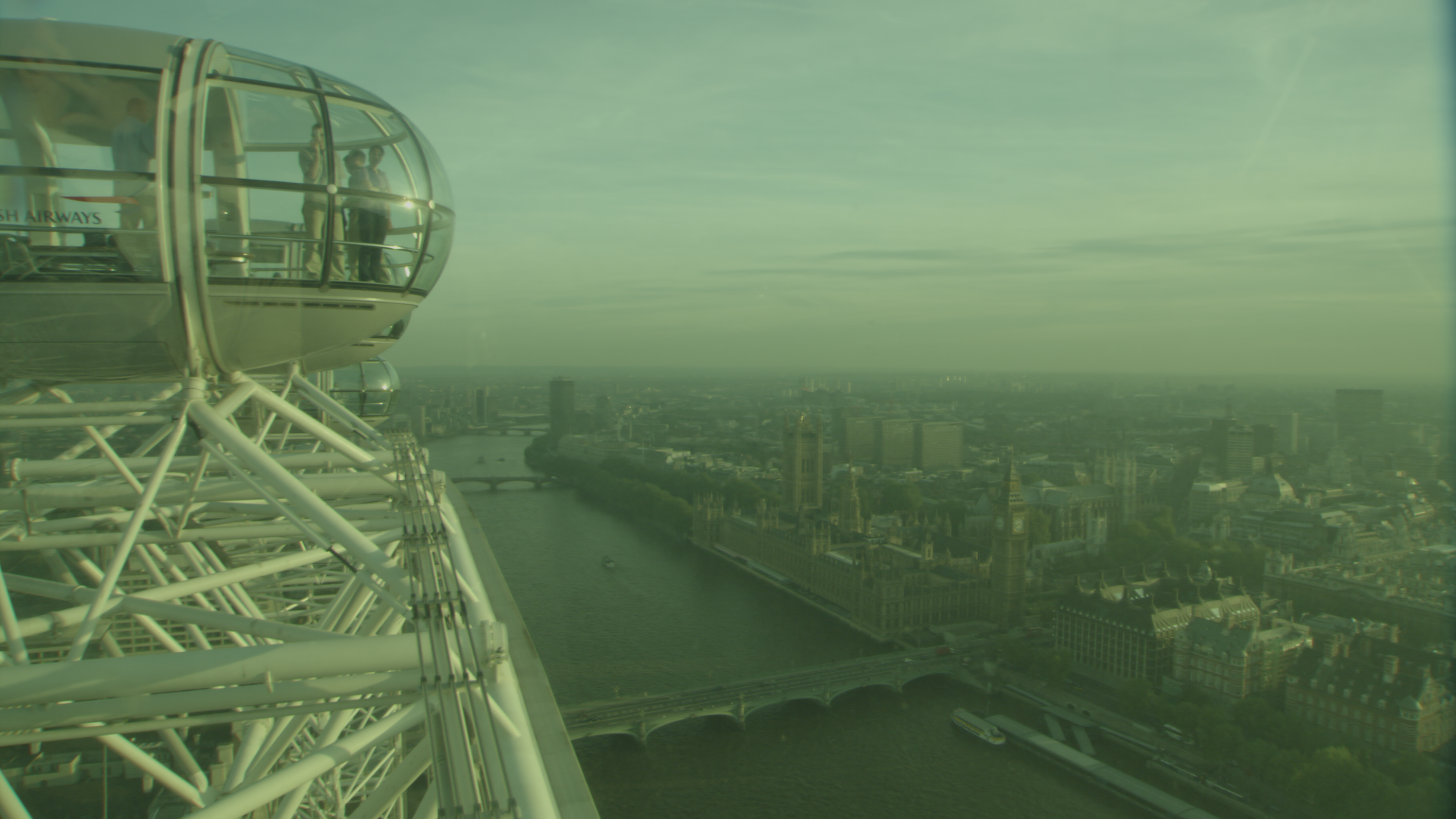

Let's try this instead.
The original image is not mine. It was downloaded from Cinematography.net as a RAW Viper image as a DPX.
What we have are the original, and 3 processes of work that I did to it.
1. Original
2. Contrast correction with 1-light color pass (aka white balance)
3. Color correction with 3-wheel color corrector
4. Saturation added, color tweaked, output set of computer RGB for showing online.
From here, someone would then do a color grade to match other footage or impart a "look". The idea here was simply to get back to "normal". And since I have no color reference I am absolutely guessing at what the scene might have looked like.
what's better for post low chroma or high?-londoneye_raw.png   what's better for post low chroma or high?-londoneye__contrast_1color.png
what's better for post low chroma or high?-londoneye__contrast_colorcorrected.png   what's better for post low chroma or high?-londoneye_final.png
Old December 17th, 2009, 02:36 PM   #14
Location: USA
Posts: 1,684
Better yes,
But it feels to me I'm still not seeing much color in the city or the river. Still doesn't pop to me. That might be just the effects of haze, and it might be appropriate for the shot, but could it also be the result of a low chroma original?
Old December 17th, 2009, 02:49 PM   #15
Location: Tallahassee, FL
Posts: 4,100
Better yes,
Pop? Dude they're a half-a-mile up! Of course it's not going to pop. Have you kooked at a photo of London even on the ground?!
I've got another one coming with more color...
