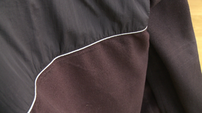

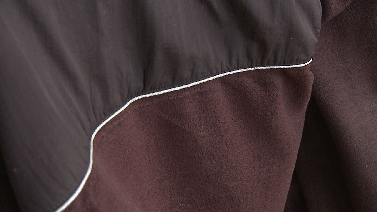

Just got mine home.
'IR contaminiation' (actually oversensitivity to far red, but whatever) - is almost identical to the EX1, though the image from the EX1R does seem a tad less red. This was not the most scientific of tests.

Because SD compatability doesnt support frame rate changes?
on this reds being to high on the dark side, there is an insane ammount of color correction items availables in these cameras, isnt there a control for the red low side, or a black level curve for the seperate colors or anything like that?
on your pics the one has more color , or red on the whole thing, not just the blacks, unless all of that is supposed to be black :-) I processed both to have the same saturation (in the only color i can see) and the one still certannly has less red in the black.

The top part of the jacket is definitely black, the lower fleece was one black but is now - to my eye - a very dark maroonish brown, but when I first bought the EX1 that fleece was pretty much black. Whilst I've seen it fade, the EX1 has not.
I really don't wish to expound on the 'brownish blacks' issue other than to say that it doesn't appear to have gone away entirely with the EX1R though perhaps there's a smidge of improvement. For situations where it's critical, there's a filter for it.

Well i can see that black being a problem on the one, the other one i dont see where it would be a "problem" for me, just looks like the usual color noise.
i call that fixed close enough for me.
