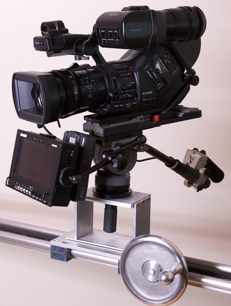

But a lot of the time in the field, I just use Noga Arm attached to my tripod head, I make a bracket for this, and I flip the monitor around and position it just under the lens. I have a sunshade on my Marshal for this.
This system works very well. I do a lot of work with law enforcement officers talking about safety, and they love this system. I can even set up to use it on a jib or on the SteadiCam, it is very light. You can't tell that they are reading just below the lens.
I use a MBP with "Presentation Prompter" SW, it works very nicely.
If you want more info I can post some photos.

I have a small above the lens Prompter from Q Vision, it works fine. It was made for Betacams, but I have made a special setup for my EX3/EX1 that works very well, I will post pictures if someone is interested. I also have full large studio below lens system. It is very bulky compared to the small above lens system.
... if you're not using a mirror system, do you favour above or below the lens?
As I wrote earlier I often use a small Marshal Monitor below the lens.

Here is a shot of the "Marshal Promter", on an EX3.
Outside I use a sunshade on the monitor. This is a really fast easy prompter setup.
BTW you may notice the hand crank slider system the camera is on. I have a number of different slider systems I am working on. This one can do incredible slow dolly moves.
If anyone is interested in the prompter arm setup or the the Slider. I will be looking for Slider Beta testers soon.
