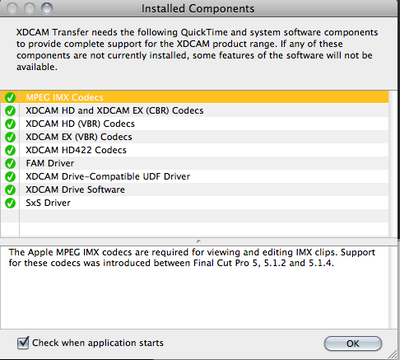

Do you have all this installed, see attached image.
You can check when you launch XDcam transfer in the Help menu.

You need to install the Sony USB drivers, it is part of that package.
Install everything from Sony. You can then ignore the Transfer program.

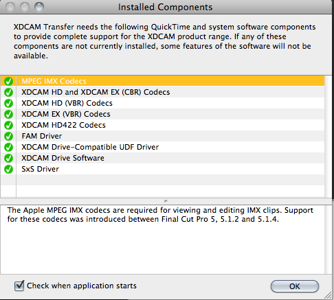

I seem to be striking out. The US sony site keeps giving me a blank white screen. That last site linked has the transfer software that I already have.
The disc that came with my camera doesn't have the transfer software, only clip browser; an old version.
Most of the components for the transfer software I downloaded are disabled.
