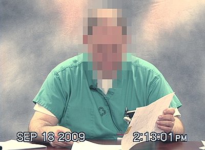

I believe you're correct Kevin. A Time & Date-stamp image should be superimposed in REAL-TIME within the camcorder during recordings. NOT from Meta-Data, or TC.
I know this may sound silly, but Attorneys can argue that post production work was done to manipulate his/her client's testimony during a deposition from the absence Date & Time-stamp
( For Example: creating a Time & Date-Stamp through post-production could be considered "Not Authentic" to the Court Reporter's Notarize Transcript).
A permanent Time & Date Stamp image should be "burned-in" the video.
Sony's DSR-250 & HVR-270 are capable of this feature.
I have no idea why Sony skipped this simple feature from the XDCAM Cameras ( EX-1, 3, PMW-350 & Optical disc Camcorders)
I could only hope that this feature will be available with a firmware upgrade.
Attorneys want the Time & Date Stamp image to look like the attachment I've included.

I have delivered video for legal purposes, it is not a big part of my business, since the time of Betacam.
Even back then we used TC and UB that was part of the file (analog Beta Tape).
I would then make a VHS with burned in TC and used my M100 to add the date (UB).
I am not a lawyer (so I will not argue fine points here), but all the videos I have done this way have never been questioned. And they have been used in court.
There may be some new legal requirements, but I have not heard of them.
What is the difference between a tape with TC and UB and a file with TC and UB as part of a digital file? Frankly both can easily be faked.
The key is the witnessed written statement that goes with the video tape/file.
I would do whatever your client requires.
