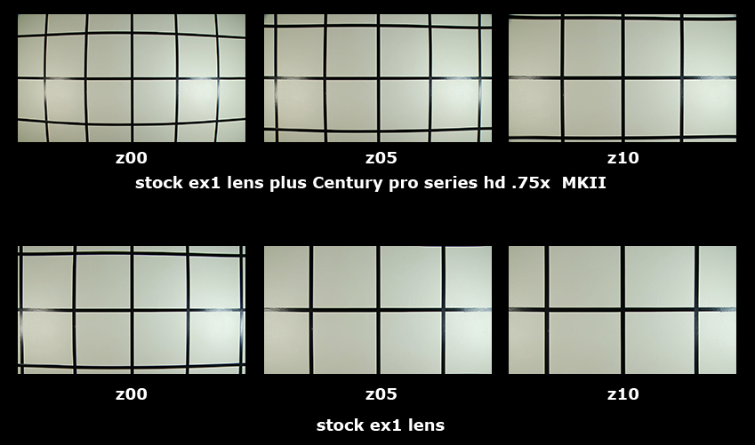

Any .6x wide adaptor is going to give you a lot of barrel distortion I'm afraid. The EX1 lens all by itself has quite a bit on the wide end, and an adaptor lens will make it worse. Here are some tests that I did with the Century .75x - I'd expect the distortion to be even more extreme on a .6x. I have the .6x Century lens for my Z1 and it has pretty severe distortion. http://www.dvinfo.net/forum/attachme...distortion.jpg
