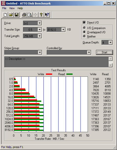

I bought one of the new 32GB Patriot IRIS SDHC cards which are designed for pro video use and come with a 5 year warranty.
Patriot IRIS Memory Card
http://www.patriotmemory.com/product...&id=896&type=6
Using the ATTO Speed benchmark, I am getting 17 MB/sec write speed and 20 MB/sec read speed, which is the fastest card I've tested to date.
