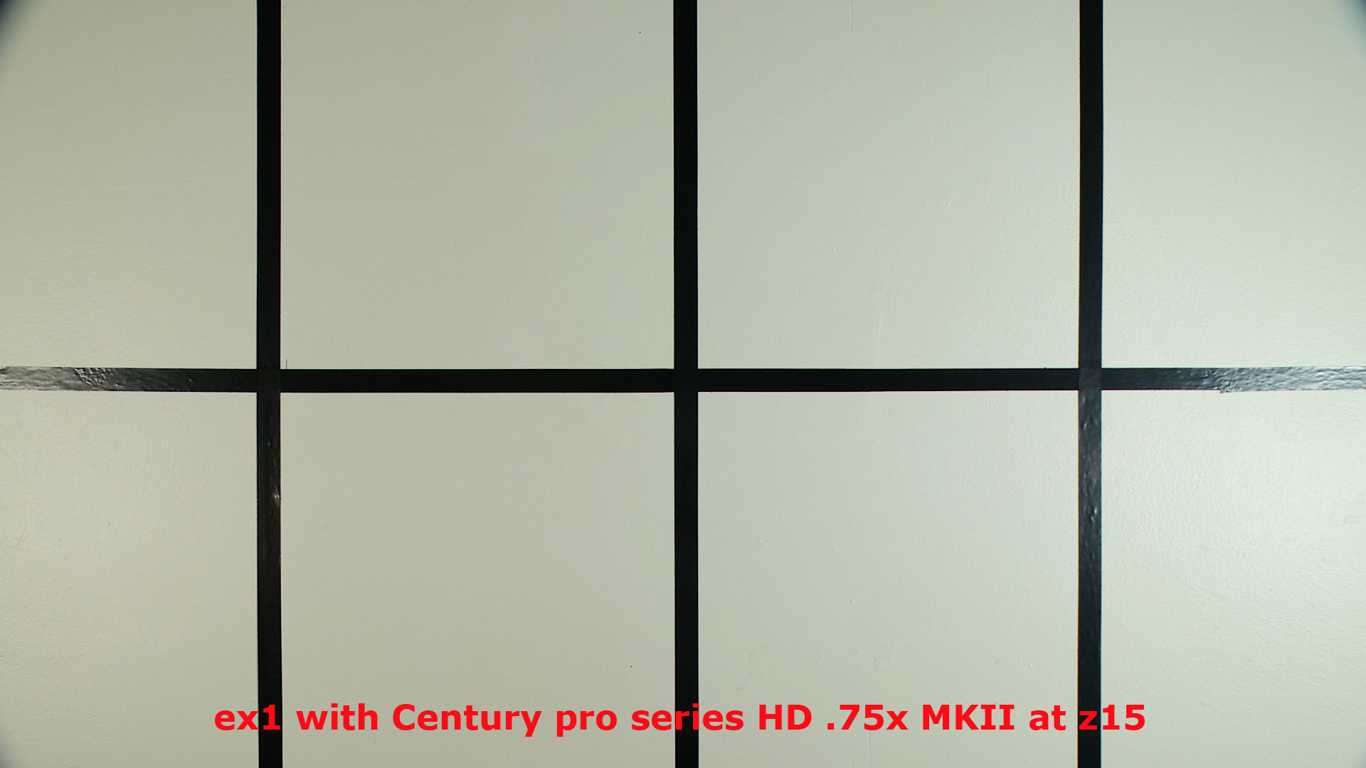

Originally Posted by Ryan Avery View Post
The newest version of our .75x does not vignette on the Sony EX cameras. There have been some reports in the past of vignetting in underscan only but that was based on the very first older units which we corrected at the first notification of an issue.
Ryan, this has not been my personal experience unfortunately (I tried to contact you via e-mail recently, but perhaps it didn't go through?). I purchased the .75x last July at B&H and the model number is 0HD-75CV-EX3. I assume this is one of the newer lenses? I see vignetting in the upper left corner on my EX1. It can't be eliminated by zooming in, and in fact it appears to get worse. See: http://www.dvinfo.net/forum/sony-xdc...ml#post1236144. It's especially noticeable here: http://www.dvinfo.net/forum/attachme...-cons-wz15.jpg. Also some discussion on this topic here: http://www.dvinfo.net/forum/sony-xdc...revisited.html
Do you think that these lenses may be defective, or possibly older stock which is still in the pipeline? I have a number of Century/Schneider products and have been extremely happy with all of them except this lens.

Originally Posted by Boyd Ostroff View Post
Ryan, this has not been my personal experience unfortunately... I purchased the .75x last July at B&H and the model number is 0HD-75CV-EX3. I assume this is one of the newer lenses? I see vignetting in the upper left corner on my EX1.
I have the same issue with my second gen .75 Century WA zoom through for my EX3.
Ryan were there a batch of the new ones where the alignment was off?

Andrew,
The second generation version of this adapter can vignette depending on chip placement from Sony.
The latest generation coming off the line does not vignette on any cameras no matter the normal chip placement.
