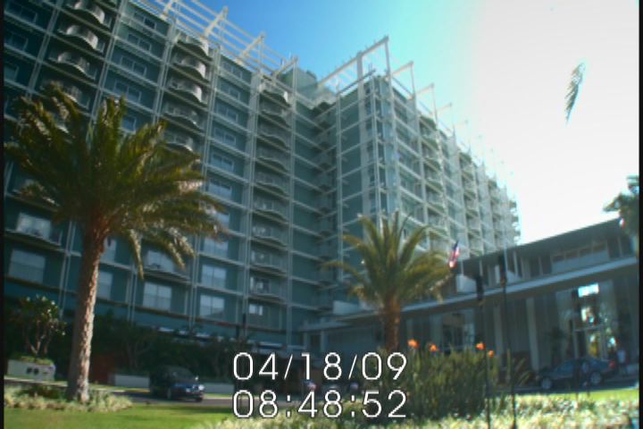

Here is a screenshot of an EX-1 frame from an Edius timeline. Original shot was 1440x1080, opened in Edius 720x480 SD preset.
1. Set the EX-1 timecode mode to "clock."
2. Set user bits to "date."
3. Download your footage to your hard drive.
4. In Edius, go to settings/applications settings/customize/overlay/source information to show, then select recording date (2 lines) and you get the resulting screenshot.
5. From the timeline, press F11 (export), then tick the "display timecode" box.
6. Your resulting SD file will have your date and timecode burned onto your footage. In the overlay menu, you can move the time and date anywhere on the screen.
If you needed HD, simply use a HD preset instead of SD.

In legal depositions, depending on the state, they want no processing of the file at all. Hence the need to burn in straight from the camera. Once it hits an NLE they believe the file is open to modification and therefor legally in doubt. Basically the file should be visually as recorded (as opposed to metadata exposed and added visually after the fact).
