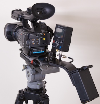

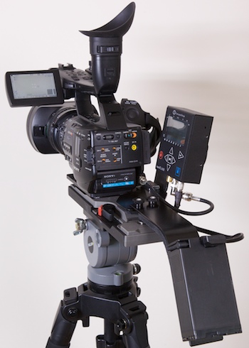

I experimented with a chest support a lot, and I never really got it to work quite right.
It is true that you can literally let go of the camera and it stays there. But it feel awkward to shoot with and restricts your moves especially fast ones.
Doug is right about shifting the camera to your right. But it is also nice to be able to line up with a hoodloop on the LCD. That is why I made my brace so it pivots to either position.
olof@westsideav.com
Stronger Tripod Plates . NanoFlash Brackets . Sliders by Westside A V
Here are some photos of my solution:

I absolutely agree with Olof (whose shoulder-mount solution I'm using) - any chest or abdomen support just sucks.

Therefore, I can only confirm once again that Olof's solution is the best one can imagine for a camera like the EX1 with Hoodman loupe:
- it feels like a full shoulder mount, in that you can freely tilt and pan with no body motions being conveyed to it
- it's still a compact rig, that you can put into a small and unobtrusive bag.
