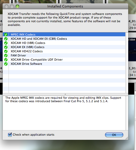

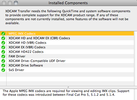

Gregg,
Make sure you have the latest everything including SxS driver.
I have been using 10.6.2 for a couple months now on MBP and MP's no problems at all after Sony's latest updates.
Link:
Sony of Canada E-support
You need all this installed:

Hi Olof
I seem to have every component except the SxS one you show - how/where do I get that one and do I need it as XDcam seems to work without it...Here's my list...and I just downloaded the SxS driver from your link above and installed it but still no SxS driver shows in my list - what to do?
Have the SxS problems been resolved with Final Cut-screen-shot-2010-03-02-3.24.59-pm.png
Kent Beeson is offline   Reply With Quote

I've tried to download it twice and it seemed to install, but it never shows in my XDcam transfer component window - thoughts?

Old March 5th, 2010, 11:12 AM   #15
Join Date: Oct 2009
Location: West Texas
Posts: 266
Well, no, I cannot use FCP 7 to import any files shot on EX1R at 24p...I can import 30p, but any and all clips at 24p make FCP 7 crash, even when I scroll in the browser, the thumbnails of the 24p shots make FCP crash.
I have to use XDcam transfer, cannot use FCP 7. So I thought maybe if I could get this SxS component all would be fine - but strangely when I install the SxS driver, it says it installed it but I can't find where nor does it show in the component list...
Thoughts?
K
