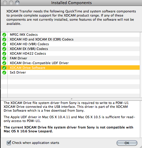

Thank you very much, seems to be working. Though, I'm still getting this message on launch. Any thoughts?
Click link

It is only for The PDW-U1 unit, you don't really need it. So don't worry about it.
