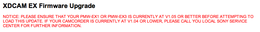

Out of interest I visited the Sony XDCAM EX micro site again this evening and find that this notice has now appeared. Not sure when it got added. My part screen grab is not easy to read so I've copy and pasted the text below too.
[Note it mentions much lower/earlier versions of Firmware than those mentioned so far in this thread....also this warning has NOT yet appeared on the UK Sony XDCAM EX Firmware download site as far as I can see - when I just checked].
"NOTICE: PLEASE ENSURE THAT YOUR PMW-EX1 OR PMW-EX3 IS CURRENTLY AT V1.05 OR BETTER BEFORE ATTEMPTING TO LOAD THIS UPDATE. IF YOUR CAMCORDER IS CURRENTLY AT V1.04 OR LOWER, PLEASE CALL YOU LOCAL SONY SERVICE CENTER FOR FURTHER INFORMATION."
