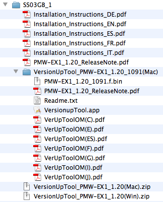

Hi Brendan,
what do you mean by 'not downloading anything' ?
Can't you download the software from the SONY US site?
Anyway, here is the direct link to the software on the european site:
http://support.pro.sony.eu//software...&model=PMW-EX1
If you haven't done so before, you have to login or register before you can download. I don't know if you can use a login that you use for the US site.
After unzipping the appropriate files you wil get something like in the attached screenprint.
Then I'd suggest you read the Installation Instructions, the release notes, the readme file and the VerUpTool pdf.
Then, if you follow the additional description I wrote earlier, I think you will be able to get the firmware updated.
Good luck,
Robbert-Jan
Firmware update EX1 v 1.11 to v 1.20 on MacBook Pro with OSX 10.6.2-contents-ss03_gb_1.zip.png
