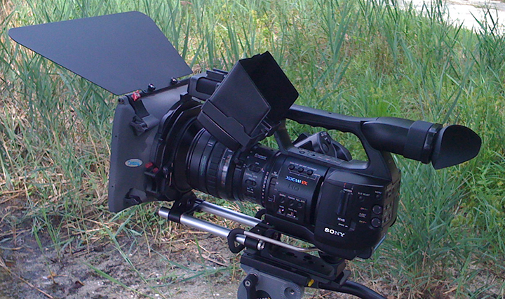

The Vocas mattebox is sold in the US by Century/Schneider: http://www.bhphotovideo.com/c/product/563681-REG/Century_Precision_Optics_0DS_MB44_WEX_0DS_MB44_WEX_4x4_DV_Matte.html
I have one of these myself and have been very happy with it. You need to insert filters from the bottom when using with the stock lens, but when I use with my Century .75x, it moves the mattebox forward enough that filters can be inserted from above. However, when using with the wide lens you can only use the filter holder closest to the lens or you get vignetting. Not an issue unless you need to use two filters with the wide lens. The LCD screen just barely clears to allow opening and closing.
The build quality is great, and it comes on and off very easily with some quick-release latches and a thumbscrew. Actually I had not realized that it was carbon fiber! Whatever it is, it's rugged and attractive.
You could start with just the mattebox and add the rods later, but I would personally not be comfortable hanging it off my lens without the rods. Here's photo of my EX1 setup.
Mattebox question: Genus et al-century.jpg
Old May 15th, 2010, 05:59 PM   #45
Join Date: May 2002
Posts: 762
Boyd, I'm thinking more and more about the Vocas like the one you have. A couple questions: Do the "eyebrows" merely act like the shutters on the stock EX1 lens shade or do they work as an adjustable masking device? Are those eyebrows worth the extra cost? Also, is the fold-down shoulder brace a solid add-on or is it flimsy? Thanks for posting the photo.
Dave Morrison is offline   Reply
