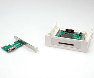

anyone tried this model sxs reader,work with sxs?Cost 31 usd

Who makes this? It looks identical to my Siig Expresscard to PCIe adapter, except mine is black.

I do not know, says that is produced by Roline,Manufactured in China :-),Steve,your reader works with sxs?

I too have one in black. It came from Synchrotech.
PCI Express to ExpressCard 34|54 Slot Drive Read-Writer Front, Synchrotech
Works OK but there's no hot swap. You must boot with a card in the slot. To change cards:
Pull the first card.
Use device manager to repoll for drives so it knows the card is not longer available.
Insert the new card.
Repoll again.
Annoying but not overwhelming and much faster transfer than the Sony USB reader (I have that on a second editor).

Yes, the Siig adapter works great with SxS cards. PROVANTAGE: SIIG Inc. JJ-000082-S1 PCIe to ExpressCard Bay
I use it on a PC and its the same process that Marc explained. The Siig adapter can fit in either a 3.5" or 5.25" bay (it comes in a 3.5" and includes an adapter to fit into a 5.25" bay), and it costs under $50.
