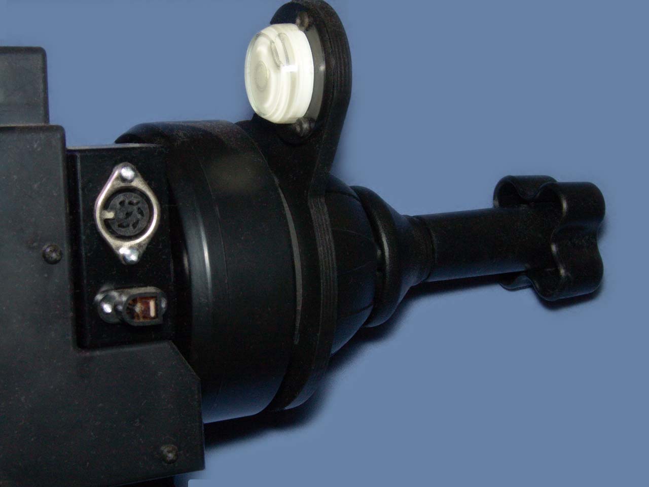

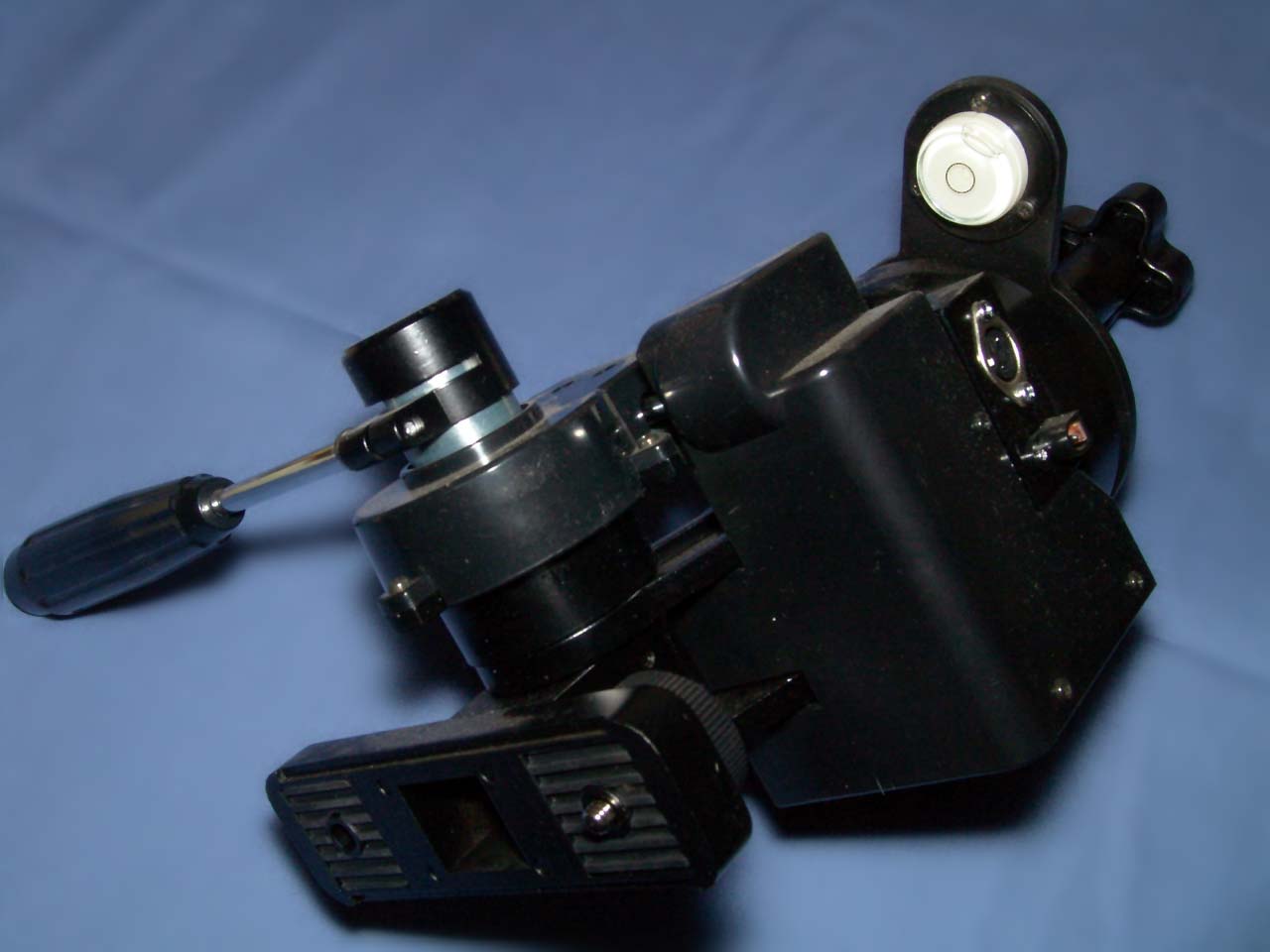

I've got one from Mizar Optical Instruments in Japan: KD Motor Mount
I believe Phill Bloom bought one as well.
I've modified mine so it'll mount on 75mm bowl and added a bubble in the process.
i machined a piece of 6mm aluminium plate to attach both a bubble and a Miller DS10 head "nut" assembly I bought as a spare part from Miller. This allows me to level the unit on a tripod. I've also bought a Fader ND filter from Lightcraft Workshop via eBay. Yet to try the combo with the filter.
Please excuse the horrid photos taken in a hurry. If anyone wants anymore info ask away. I don't have a machine shop other than a drill press and a jig saw. With just those basic tools machining the adaptor was easy enough.
Motorized head for timelapse-mizar-mount-1.jpg   Motorized head for timelapse-mizar-mount-2.jpg
