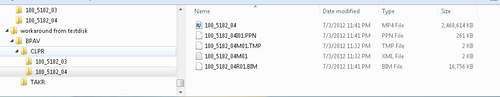

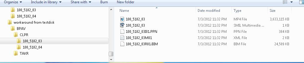

My SDHC caqrd crashed but I managed to retrieve two crashed folders; it looks like video files exist BUT they will not play or be recognized in any player (incl. VLC) or imported to Vegas. It looks like some other files in the folder are corrupted (SMIL????) how to fix it? how to edit those respective additional files in CLPR folder;
thanks in advance
(see pictures with folders content)

Just a thought, but:
- copy the mp4 onto your HDD somewhere
- use ClipBrowser to IMPORT them
If they're OK, CB should recreate the remaining files and create valid BPAVs for you.

Posts: 421
I tried and it didn't work; it look like there is some problem with mp4 files itself; how to fix them?
