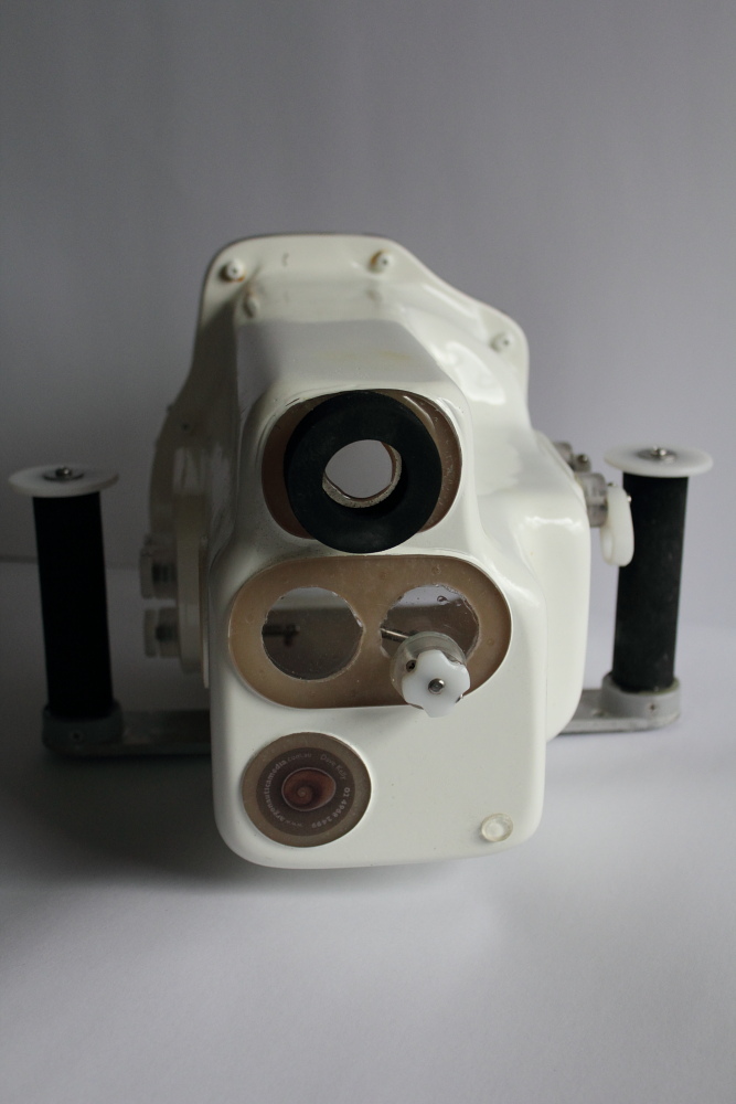

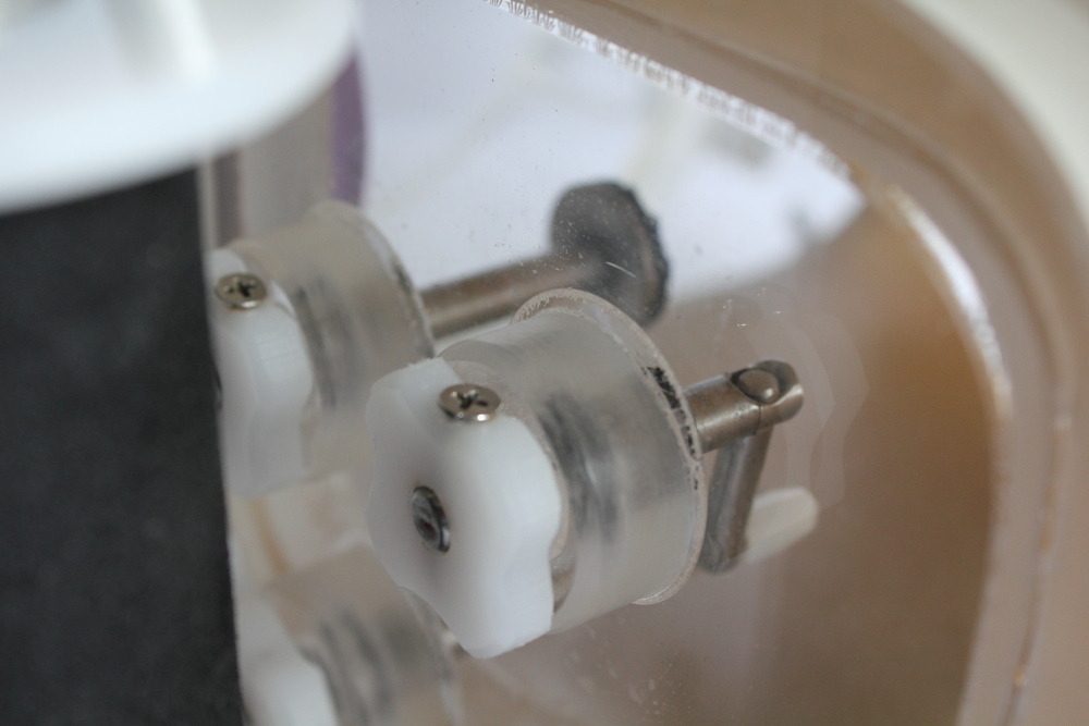

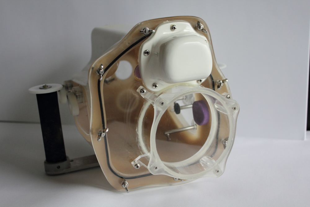

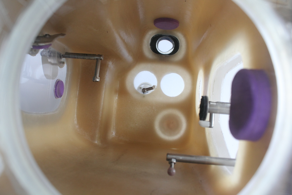

here's some pics of the housing
Custom built by Dave Kelly.
Provides
- on/off power
- zoom
- record
- ND filter select
- manual iris
- focus auto button
Been an awesome housing working 100%. Light and strong, Rated to 10 metres.
Exterior changes to ex1r?-img_0001.jpg   Exterior changes to ex1r?-img_0002.jpg
Exterior changes to ex1r?-img_0005.jpg   Exterior changes to ex1r?-img_0006.jpg
Wes Thomas Greene is offline   Reply
