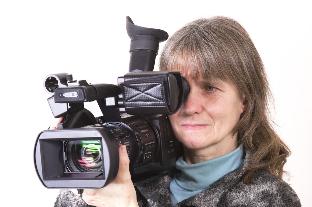

The use of a HoodLoop on the EX1 cam turns the LCD into a very good viewfinder. Almost as nice as the EX3.

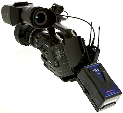

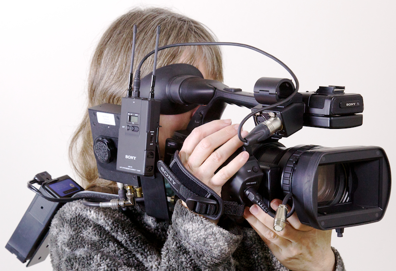

My cam before the EX3 was the DSR500. And after making a shoulder brace with IDX battery plate for it. I find the EX3 to be just as balanced as the 500, but a lot lighter.
And the HD image quality of the EXcams is terrific.
The EX1 can also benefit from my shoulder brace system. Though if you are going to primarily shoot on the shoulder I would get the EX3.
95% of my shooting is on sticks StediCam various dolly's or tracks. But I do shoot off the shoulder from time to time. If it is just a 15 minute session on the shoulder and them back to the sticks. I like my EX1R with a hoodloop and my short shoulder brace. If it is a longer period of shouldering I will grab my EX3 with the IDX batteries on my brace to balance the cam.
I often use the NanoFlash with the EXcams and it adds 422 recording that really helps for heavy grading projects and it keeps the BBC etc. happy.
Below are a couple photos of the shoulder setups.
If you have any more questions contact me.
