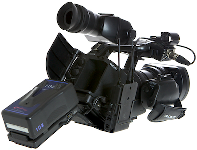

I make a simple EX3 shoulder brace system that uses either Gold-mount battery plate or V-mount IDX plate.
This balances the EX3 very nicely and also adds a great deal of strength to the tripod mount. It also comes with an optional wing for mounting wireless mics NanoFlash etc.
And I can also incorporate a VCT-14 quick-mount wedge to the plate.

Yes, I have the AB accessory with a dionic 90 .... it fits very well and helps a lot with the overall balance of the camera ..... once mounted, the EX3 feels as if always were designed to use a dionic .... one minor note: take care if you turn "upside down" the camera ... this may cause the qrex3 "slips down" from the camera...the plate fits on the original battery compartment but doesn´t "click" on position ....
overall ... very recommended...

I have it as well. Mine doesn't "click" per se but it stays in place. It is incredible value for the money. I think I paid $135 for it (or thereabouts) and it includes an Anton Bauer gold mount which alone retail for $100 to $125, a built in cable that goes to the EX3 and the ability to attach BEC plates to it which some people use for mount Lectrosonic wireless devices to but I slap industrial grade velcro on the plates so I attach either a nanoflash to it or some other accessories, usually my Sennheiser G2. It also should be noted there is a P-Tap connector (as there usually is) on the side of the Gold Mount plate so you can a powered accessory from it or a Power Tap splitter so you can run a bunch of stuff from it. I keep it in one of bins that I take out on shoots as a just in case device. I use it a lot when I am doing tripod work. If you do a lot of handheld it certainly does help out not only with throwing weight off the back but also towards the grip hand.
If you have Dionics or Hytrons it is a no brainer.
