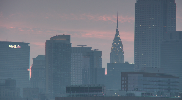

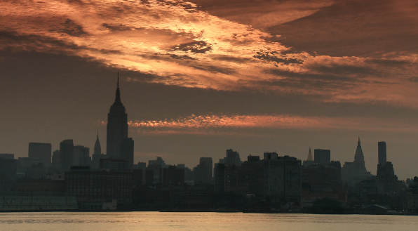

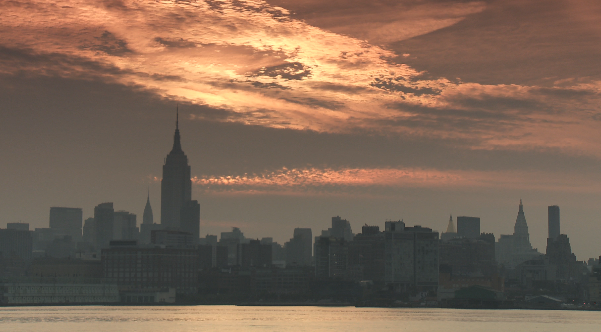

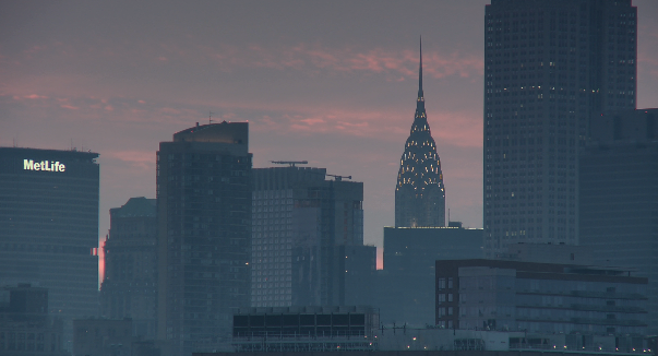

I've attached two samples. The one with blacker blacks is what I want, the less contrasty of the two is what I am getting. If I go to standard 3 gamma, by your own experimenting and suggestion, I will increase noise.
Obviously, it is simple to make the adjustment in FC or MC but then, upon close inspection of the final 1920x1080 quicktime file I see added noise in the grey areas that is not there if I do not contrast correct.
I have no other way of viewing at this time other than on Apple monitors 23 or 30". having read that the qt player can add noise of its own, I wonder if I am chasing a ghost.

Sorry, didn't properly attach the files. They should be here now.
Profile setting for increased contrast-picture-5.png   Profile setting for increased contrast-picture-6.png

another example
Profile setting for increased contrast-picture-7.png   Profile setting for increased contrast-picture-8.png
