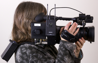

You could check out my shoulder brace system for the EX1:
Westside A V Studios WEB Store

I'm using both the RR shoulder mount and Olof's rig, though in a slightly different configuration than depicted in his post above (with the "small" shoulder pad). Each has its uses in different scenarios...
The RR is based around the rails, so sooner or later you will think what the heck, and add the mattebox to it. Also, the EX1 seats quite high on it, so that it's difficult to use its own LCD (though possible, especially with the Hoodman loupe). So, the next thing you do is mount a field monitor to the rig! By now, it's already large and heavy, but also quite unbalanced with most goodies at the front....So inevitably, you would add some large battery behind the camera, in order to balance the whole ring on your shoulder! This is how I use it, and can tell you it's close to 15 kgs...
On the other hand, Olof's rig is the lightest and most compact solution imaginable, and allows to use the EX1 with nanoFlash without any fatigue for a long time (works best with that additional weight of the nanoFlash at the back, and with the Hoodman loupe). It can also be mounted directly on the RR shoulder mount, or on the tripod, without removing a single thing. What's more, it can fit a medium sized bag without any problems...
As you can see from what Les wrote about the difference in your ability to use your hands for controlling the camera, and from my own summary of other differences - each solution has its pros and cons. The choice is yours.
