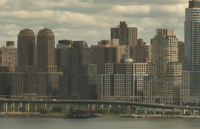

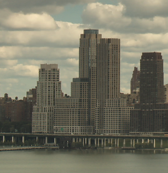

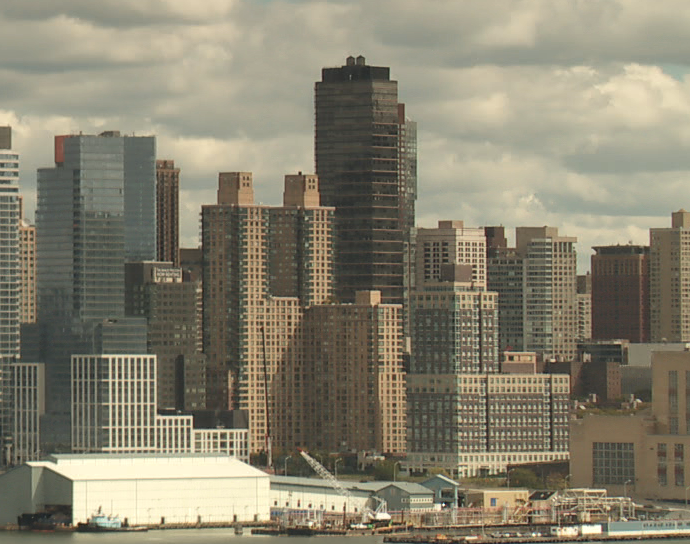

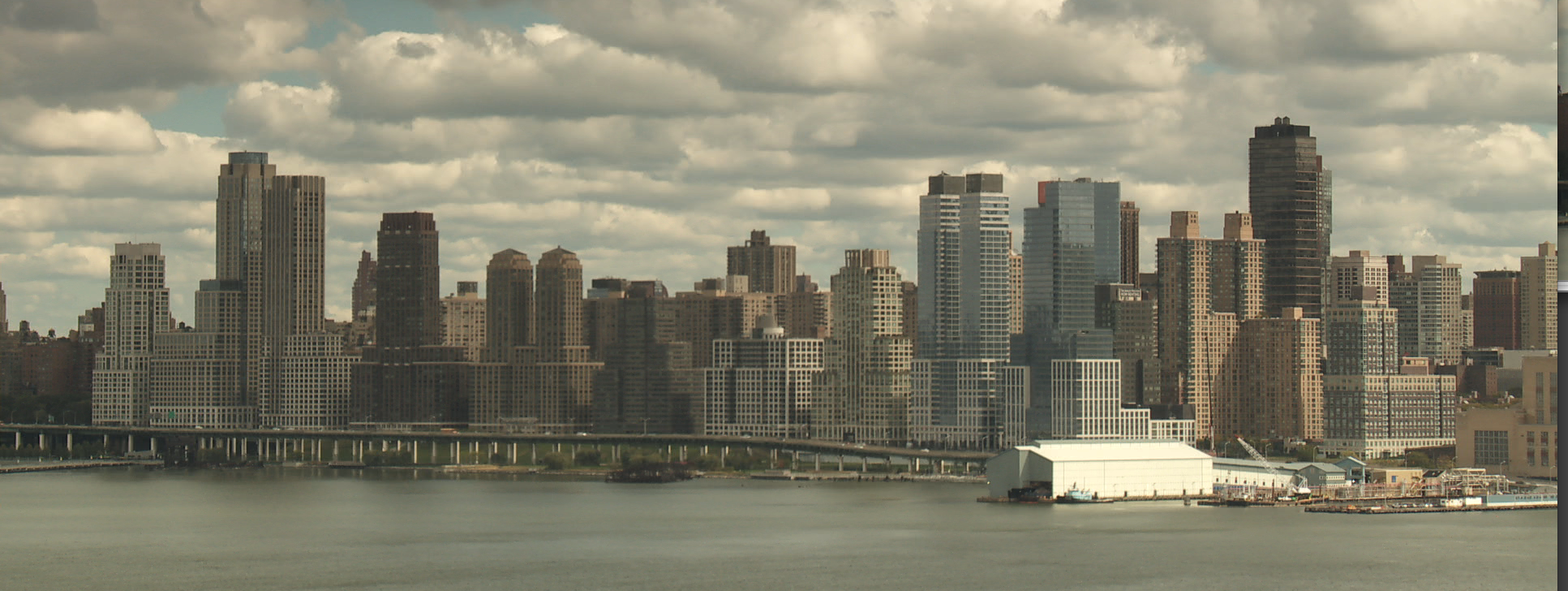

I've been having a problem with the kit lens on my EX3. Either the left side of the image goes soft or the center of the image goes soft. I just had it into Sony NJ and they realigned and re-calibrated, etc, but it is still soft in the same places when I blow up the MOV from the camera.
I brought it back today and the head tech threw it on the bench and it looked fine, even footage shot with the camera looked ok on his CRT monitor. On my Apple 23 inch screens it looks soft in the middle. In 30 + years of photography and video, I've had plenty of lenses with soft edges, but never sharp edges and a soft middle. Anyone experience anything like this?
I have attached a screen grab of edge to edge, left, right and center of frame. Note the highway in the center image out of focus compared to left and right.
Can increasing the "Crispening" to +30 (to reduce noise) affect only a portion of the screen? (long-shot)
