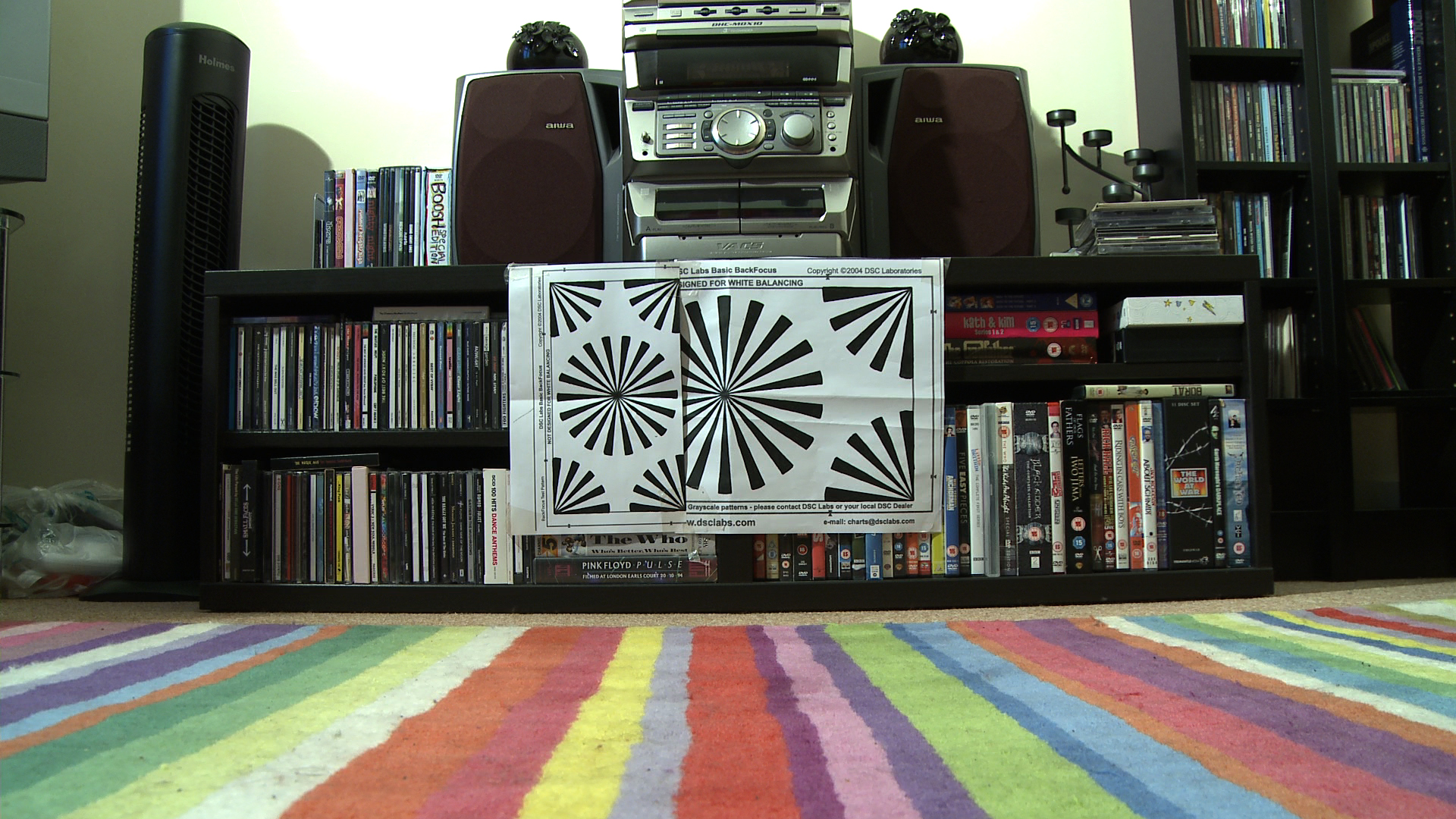

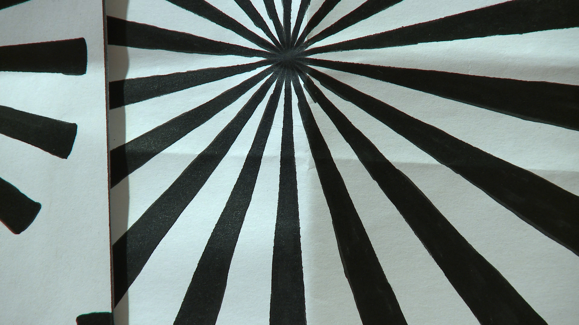

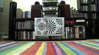

Hi guys,
Attached are the latest stills after back focus adjustment.
This time I removed my T1 filter and had the focus switched to the AUTO position! Also had ah F stop of 4.
I think the shots look a little better but still not sure.
Let me know what you guys think.
Much appreciated

Old October 26th, 2010, 11:10 AM   #23
Location: Cambridge UK
Posts: 2,853
Yep, better lit and sharper. Look OK to me.
Old October 26th, 2010, 12:07 PM   #24
Join Date: Sep 2008
Location: Southend, UK
Posts: 165
Cheers Andy,
I can definitely see an improvement. I think sometimes you look at something so much you can get lost!
This does seem better though!
