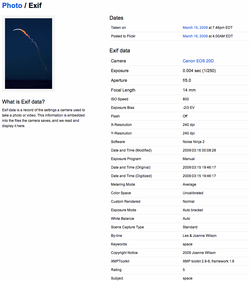

converted post to have attachment (below)

Old October 30th, 2010, 07:13 AM   #15
Location: Boca Raton, FL
Posts: 3,014
For those without honkering image stabilized 300mm L lenses <grin>, the alternative wide angle shot is still there for the taking. My wife had success with a 14mm on a Canon 20D using the settings shown in the attached. Tripod and cable release let her enjoy the launch
