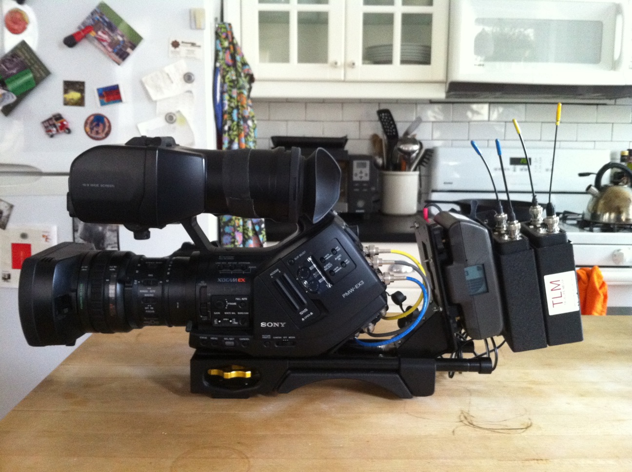

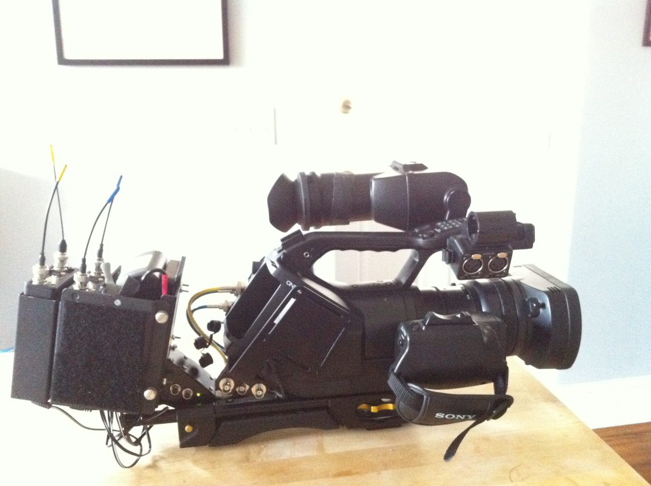

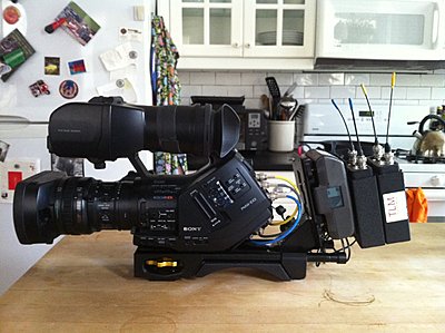

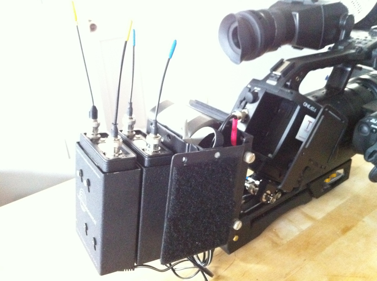

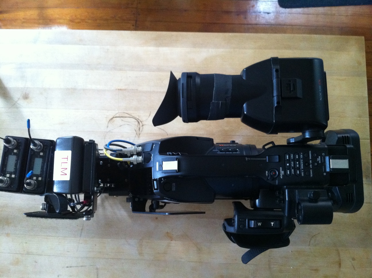

I can vouch for the EXMount. I mount two wireless, a Dionic 90 and soon, a Nanoflash to the camera creating the backweight of a proper shoulder mount camera. The VCT-14 tripod connection on the bottom of the mount makes it the most practical mount thus far in terms of moving from running and gunning to tripod work and the sliding shoulder pad locks in two positions to easily change the weight from center (tripod) to rear (shoulder). Better yet, the EX3 and ExMount fit in my traveler Portabrace bag fully assembled so I can just pull it out and shoot.

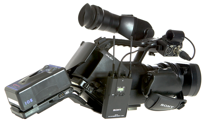

I make a very simple strong system for the EX3. It is compact and greatly improves the balance of the EX3.
It can be ordered with AB or IDX battery plate or simply by itself.
The tripod mount becomes much stronger and a VCT-14 wedge is also available.
The basic system is $225.00, wing for wireless mics etc. is available for $25.00. I also make special NanoFlash and many custom solutions, for reasonable prices. In the photo below the wireless mic is facing out, normally it faces in for protection, or 2 can be mounted one facing out and one facing in. The system is compact and fits in my runbag assembled.
