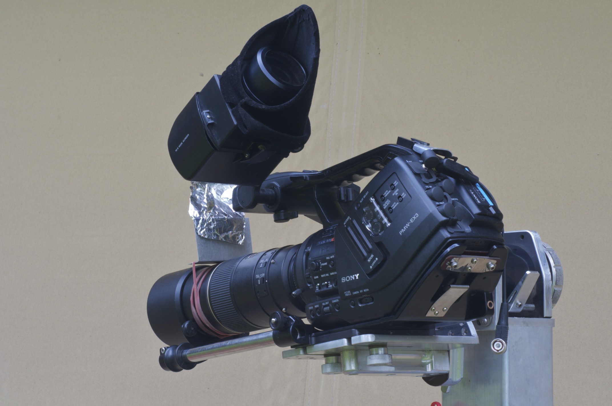

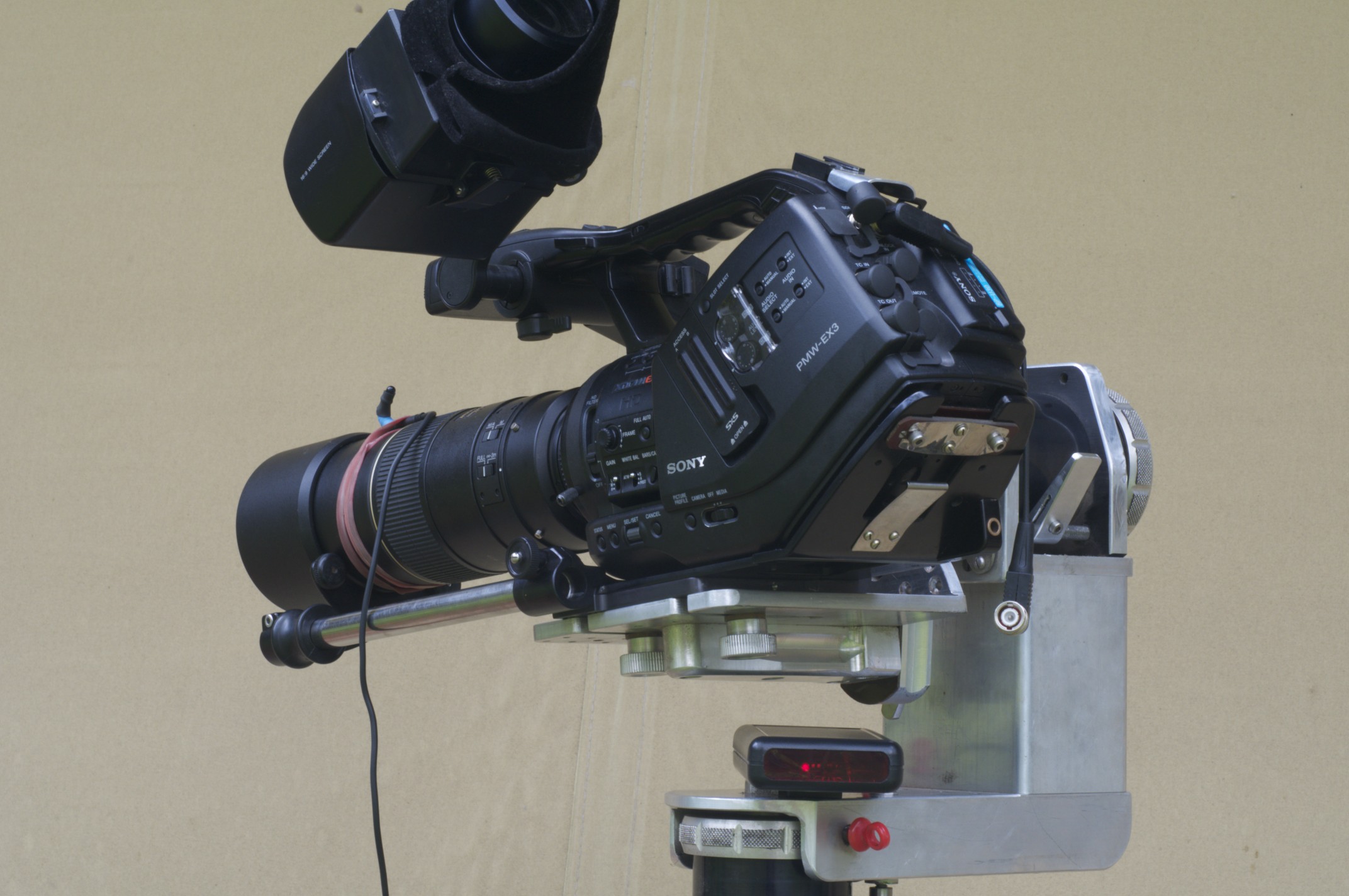

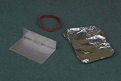

I have provided three pictures to complement my post above. The first shows how crude an IR reflector can be. In this case the piece of aluminium angle is straight from my scrap bin. The foil provides more reflection than the angle and the rubber band holds it all in place as shown in the second picture.
The third picture shows an Infrared extender that is housed in the black box below the camera. The IR emitter is held in place on top of the lens by the rubber band and its output is directed towards the IR sensor on the front of the microphone. The emitter is connected by a cable to the black box. In use the supplied remote is directed towards the red window on the extender housing.
The extender provides greater range and a better choice of positions for the operator than does the reflector option. Although the Sony remote buttons could have been laid out better I find that I can operate either of the required combinations with the one thumb., i.e. two hands are not required.
Another possibility for a remote would be a small solenoid activating one of the assign buttons, number 4 at the front would be the easiest to access.http://www.dvinfo.net/forum/attachme...1&d=1290809298
