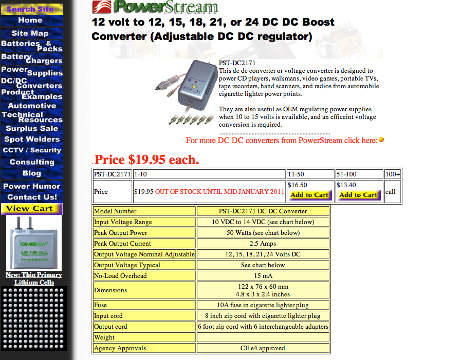

Alex. Thanks. That solves it. To leave bread crumbs for those who follow, the voltage regulator site doesn't have a URL to the part number but I have included a screen shot. It's listed under DC to DC Chargers section of PowerStream Power Supplies and Chargers for OEMs in a Hurry
TC200-EX Charger: Battery charger TC200-EX 2 position [TC200-EX] - $289.00 : Dolgin Engineering, Camera Power Solutions
Is there a way to charge EX1 batteries from DC power system?-screen-shot-2011-01-20-8.59.46-pm.png

You are welcome Les. I suggest you check with the Solar Panel manufacturer to see what max. voltage it might develop on a sunny day, to make sure the converter will not get damaged with too much...
