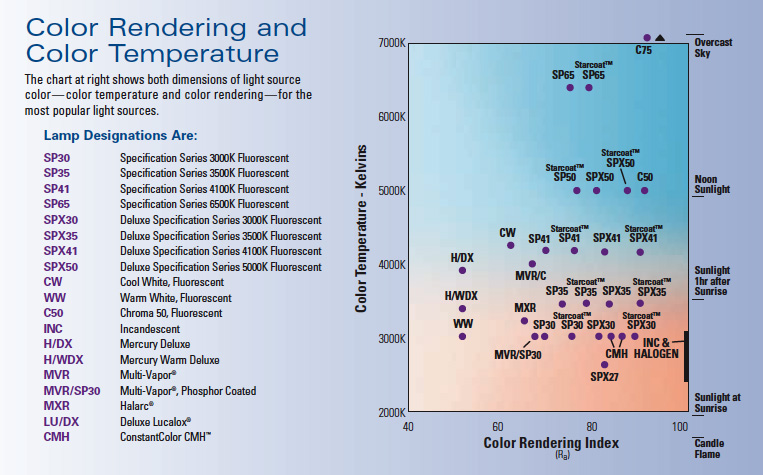

Garrett, I have also had this same question and my travels discovered General Electric's research as they make light bulbs for various color temperatures. It is a guide with some actual science behind it. Hope this helps.
Color Temp Setting for Time Laps Sunset/Sunrise-ge-color-temperature-sunlight.jpg
