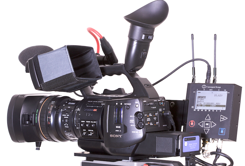

I have both batteries they both work well and charge fine on the Sony Charger.
The 96 runs a lot longer, but is heavier. I use both types to run the NanoFlash as well as the Camera.
I have used both types more than a year and they are still running fine. I have actually had more problems with Sony batteries than these.
Here is a photo of the 96 in my EX3 running camera and NanoFlash. The NanoFlash is mounted on my bracket custom made for the EX cameras, for more info contact me or check out my site.
