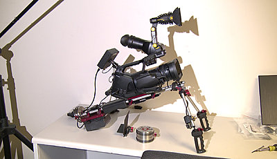

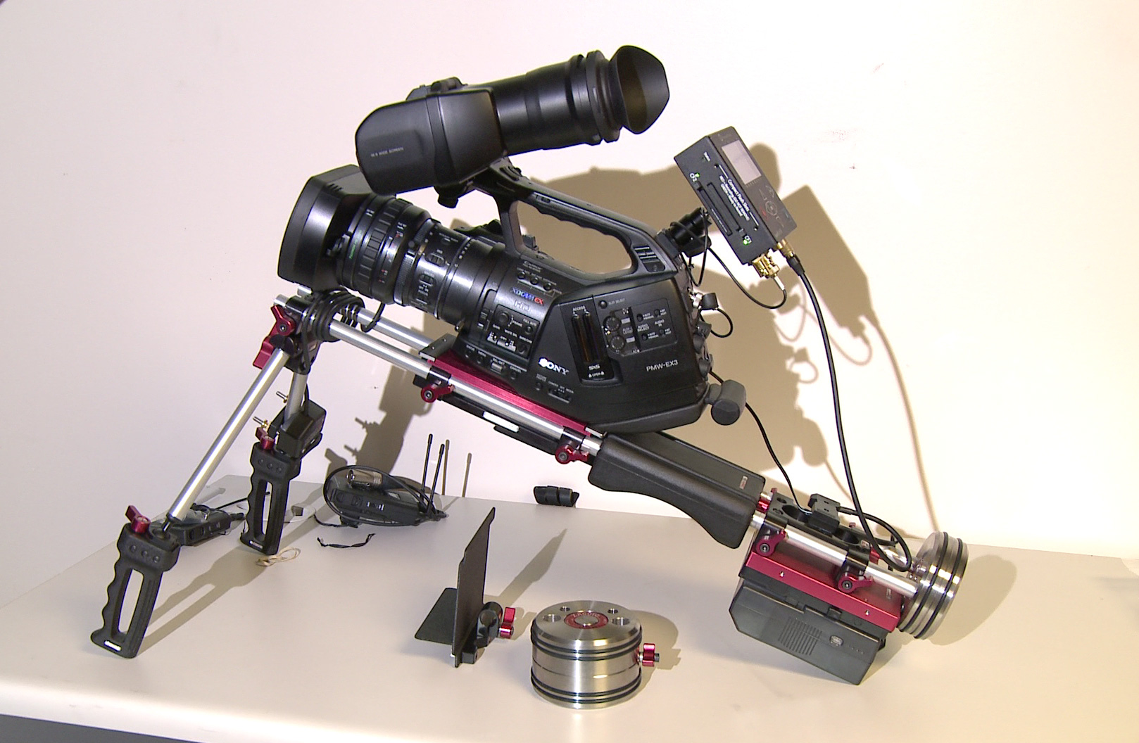

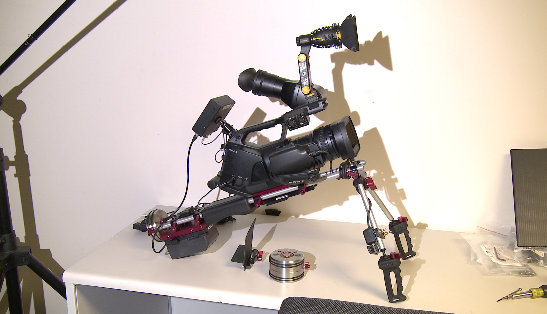

Here are some photos (taken with my EX1 and lit with a Litepanels SolaENG 3 fresnel LED light). I LOVE LOVE LOVE this light and use 2 of them instead of Arri 300w fresnels. In these images, I have a Dedo LEDzilla fresnel and nanoFlash, 88whr Swit v-mount battery, Varizoom Rock-EX and 3.5lb counter-weight. In the left photo, the rig is perfectly balanced. Before I bought everything in this photo, I tested this setup versus a PMW-350 in addition to a few other shoulder rigs and nothing came close to the Zacuto's balance, adjustability and build quality. I really think that this rig plus EX3 gives all the benefits of a true ENG camera but is much smaller, lighter and more modular/adjustable.
