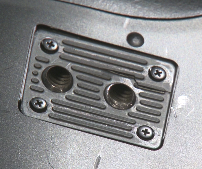

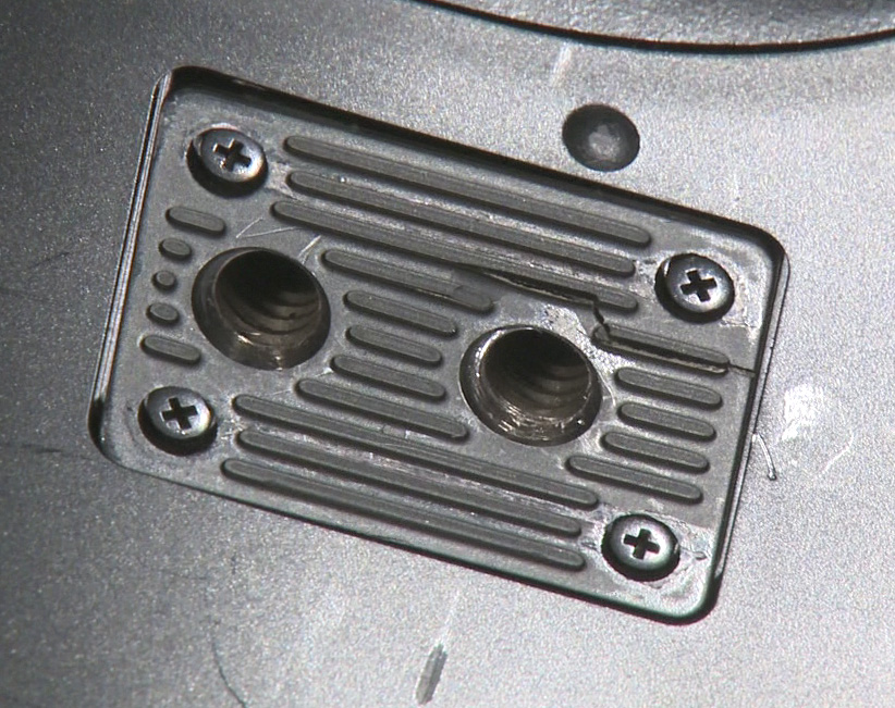

(Shots were taken with my EX1) I have been using a Zacuto shoulder rig with my EX3 and fully assembled, it weighs roughly 6-8 lbs including nanoFlash, light, v-mount battery and wireless receiver. I have tried to carry it around by holding it from underneath but my assistant has moved it a few times by the handle. I have been using it for 4.5 months and just noticed the baseplate last weekend.
Should I be worried?
Aside from Olof's baseplate, does Abel Cine or someone else sell a replacement? In my current situation, I almost have to order from Abel Cine with our account otherwise I would have ordered from Olof yesterday.

Hi Steve,
If it was my EX3 I would be very worried. As a matter of interest does the Zacuto rig only attach at this one point or does it attach at three points?

Looks like you'll want to replace the original mount and get something like this...
DM-Accessories - EX3-PLATE Reinforcement Plate for EX3 Camcorders
The above linked item is an improved version of the DM plate I got a couple of years ago.
Olof's solution is probably every bit as good.

I would definitely get that plate replaced soon. There are 4 small studs underneath the plate that have 2mm screws in them, if they brake it is a very expensive repair.
You can get the plate from Sony, or a dealer.
I have made a number of them here in my shop as well. And I have repaired some stripped studs as well.
Once it is repaired I would definitely get a plate like the one I make or DM or Cavision. They really make the EX3 a much heavier duty camera.

The problem is not just the small baseplate as a failure point.
If you were to just make a stronger replacement without adding any other support, the fail point will simply move somewhere else, maybe into a critical structure deeper inside. This may be why Sony has persisted what appears to be a fairly fragile attachment. It can fail first with minimised risk of more serious damage to the camera itself.
The centres between the tripod stud holes and the small fixing screws are very close and little force is needed to apply excessive leverage.
The aftermarket attachment designs offered are very sensible in that they seek to widen the span of the loadbearing junction between the camera and what it attaches to. The load is shared over a much larger span of structure against which it then has much less destructive leverage.
Common sense by the operator needs to have a win here. Just because you can now hoik the camera by its carry handle up off the ground with all manner of things attached does not mean you should. The handle attachment may be the next thing to break and that will be a more expensive fix.
As for your camera assistant. - To plagiarise from an old English monologue, maybe you might offer "wonderful words" of advice as you "draw him ( or her ) gently toward you wit throat".
Depending on how long you intend to continue using this camera before moving on to the next generation, I would recommend buying one of the aftermarket plates. Having one fitted might add value to the camera if you sell it onward.

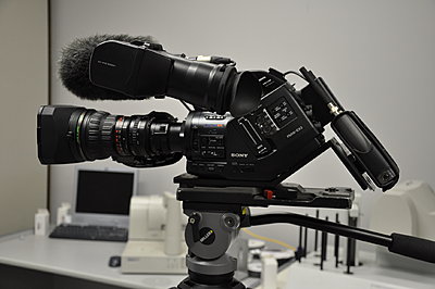

Here is mine:
Very, very good plate. As you can see, it is the full version with back plate for, ion my case radio mic receiver.
