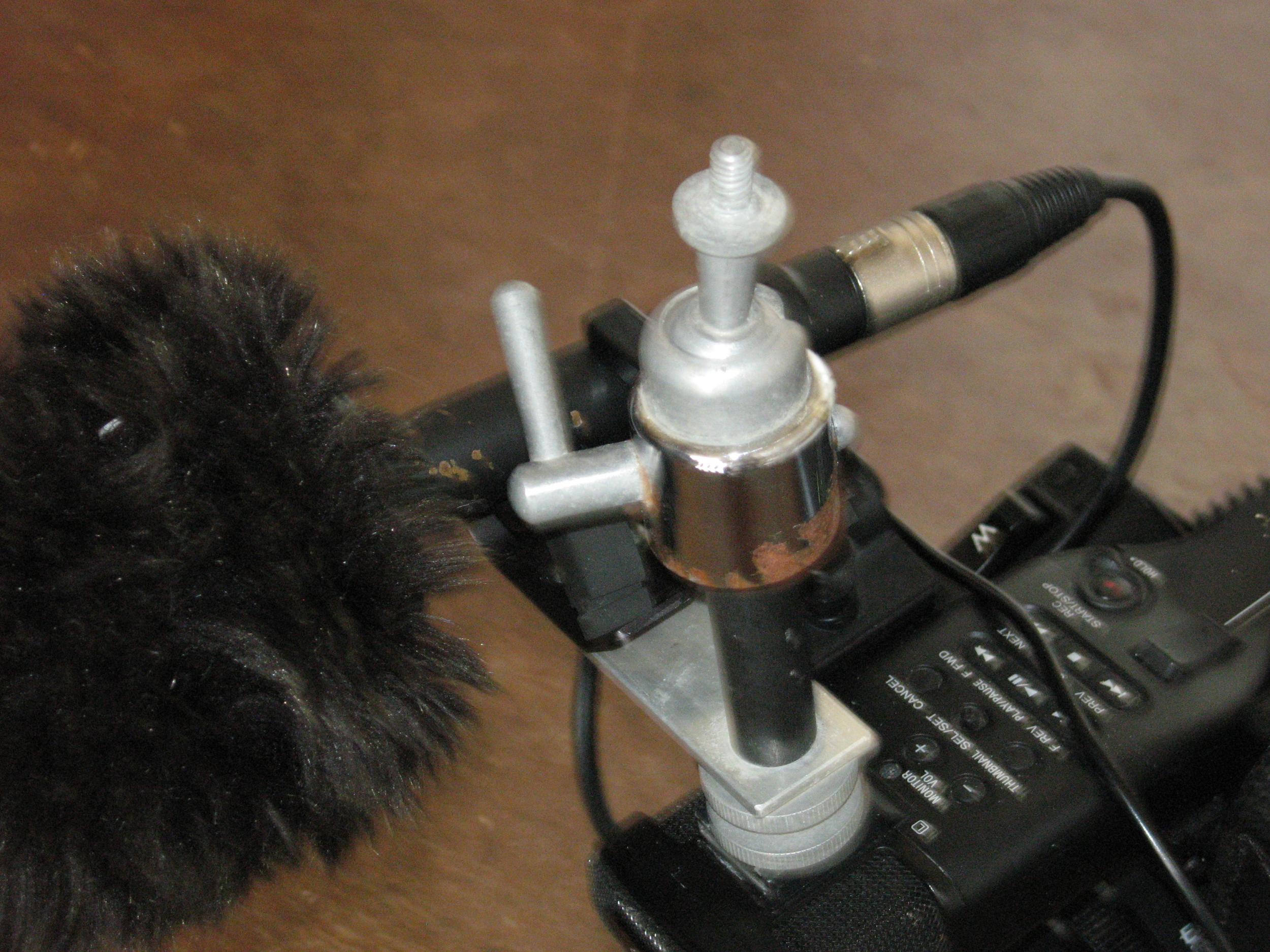

I reinforced my mic holder. However, I don't even use it anymore, and mount my mic with the hot shoe mount. I made my own, which also supports the on-camera light.
I'll post photos if anyone's interested. Be warned: it's not pretty!

Here's the mic mount. It's Lightwave shock mount that's been screwed to a flat aluminum bar. That bar is attached to a hot shoe mount. Also attached to that is a rod and ball mount which is used to hold an on-camera light.
This holds the mic further away from the lens and helps keep it out of the way of the camera light.
The original Sony mic mount isn't used at all.
Elsewhere on this forum is how I reinforced the Sony mic mount to keep it from breaking.
