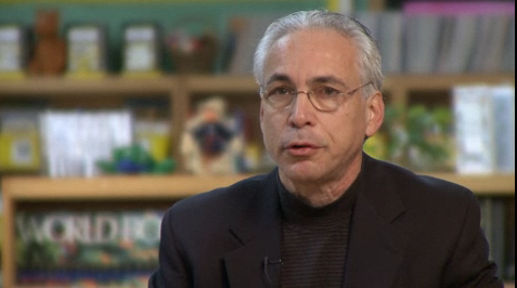

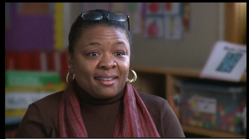

Below are some simple examples of selective depth of field using a Nikon 50mm on an EX3 with a Letus Extreme adaptor.
PMW-EX3 Lens Support-screen-shot-2011-05-25-2.34.37-pm.png   PMW-EX3 Lens Support-screen-shot-2011-05-25-2.35.39-pm.png
