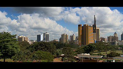

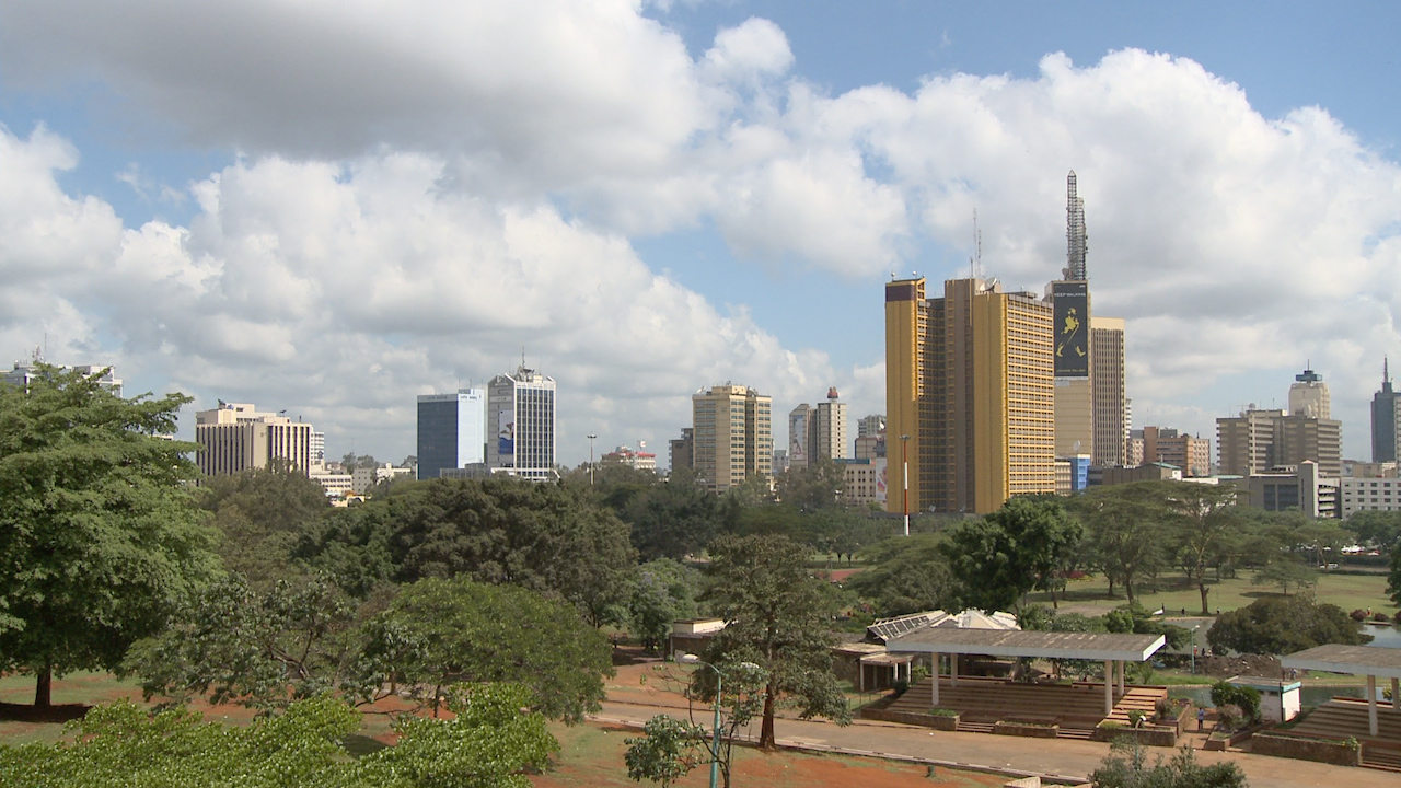

Just reading through my previous and Doug's posts. I may have given the impression that I don't use any PP's on my EX3. Of course I do, I use Cine 2 or 3, but leave most of the other settings at the minimum. The results are a fairly flat image which is then tweaked to suit the mood of the production. The best way to explain this is by showing you a before and after example.
I used RGB curves, ProcAmps for saturation and a overlay graduated ND filter generated in Photoshop and blended on the timeline. The crop was added to give the production a cinematic movie look. The sequence is a slow pan of the Nairobi skyline

Vincent, nice stuff! I would venture to say that you could not have gotten the image on the left without using one of the Cine settings. And yes, I already knew that you use a custom PP while still you're shooting neutral. That is a perfect example of what I am talking about. Whether someone intends on grading later or shooting video that comes close to the final look in-camera, you still have to use a custom PP. It is mandatory. Even the Sony engineers told be that.
