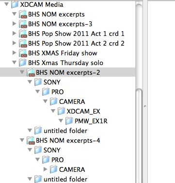

This screenshot was taken from Clip Browser. Several Questions:
The trouble folders are named BHS NOM excerpts. The only folder that has clips is the top one...BHS NOM excerpts.
I don't know how or where the folders underneath the main folder came from. What's more, there doesn't appear to be a BPAV folder. However, if I look at the same folder in the Mac Finder, there is a BPAV folder. It has a size of 12 Gigs.
I can't delete these folders either using Clip Browser.
When I open other folders in the list, such as Pop Show, I see the clips inside them. These NOM folders appear to be duplicates of something I don't understand. Sony, Pro, Camera, Xdcam, PMw etc...they are empty.
any help here?

Presumably the 'Sony' file folder and sub-folders is where camera data (camera setup and picture profile settings) would be saved when you perform a save of your camera settings.
What is in the untitled folders? That's the ones I would have expected to be named 'BPAV'

David, I'm no expert having only come to EX1Rs at the end of last year, but it seems to me that you've created some of your own folders on the cards.
If that's so, obviously you know why but my advice would have been to use the clip naming feature in the camera if you wish but otherwise leave the card file structure as is.

Actually never renamed clips or folders in the camera. I must have done this another way. What I'm not getting is why the multiple empty folders are showing up in the tree. The untitled folder was also empty. When I highlight other clip folders like the "BHS Pop Show" all I see are the clips, which is what I want anyway. I realize that there is a Sony folder on the card (I think anyway) where the custom setting can be stored. Maybe this optional? maybe I did this on a particular card. It's confusing to have the multiple tree listings associated with each clip bin.

In my experience the only 'safe' way of working with XDCAM EX is to re-format the card in the camera before each shoot (having mades several backups of course!) and not create/delete folders/files or otherwise mangle the file structure with Clip Browser or anything else.
I would not personally store camera settings data on the SxS cards either as it will get deleted every time you reformat the card. You could store camera data on an SD card using an adaptor.
