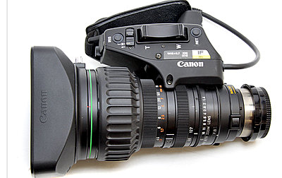

Old August 3rd, 2011, 03:10 PM   #7
Posts: 963
Re: Canon YH19x6.7 KRS
Hi Sander,
I have once seen a lens exactly like this, with a cable from the grip, that fitted a Sony XDCAM camera perfectly. So the presence of a cable is not conclusive, there are still different bayonets for different camera brands. Some of these lenses have a hot shoe for XDCAM camera's, but some others do have the cable connection (and no hot shoe), depending on the date of production supposedly. I do have a picture and I attach it here.

Old August 4th, 2011, 02:40 AM   #8
Posts: 4,957
Mine did not have a cable, itnused the Sony hotshoe. The majority of Sony fit lenses will not have the cable. There were a lot of these lenses made to fit the Panasonic 1/2" DVCPRO cameras so be careful!

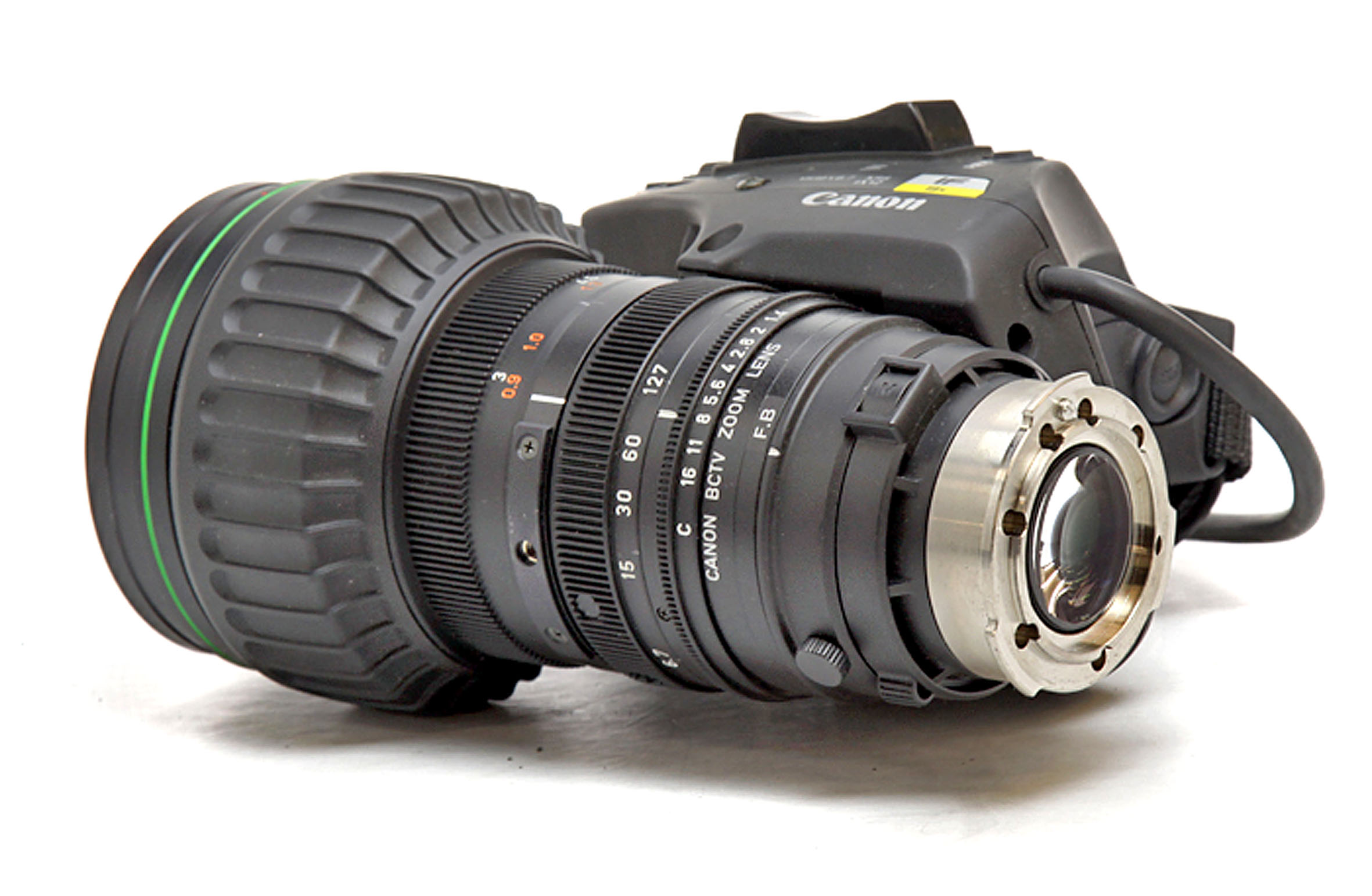

Old August 5th, 2011, 07:00 AM   #9
Posts: 963
Thanks for the extra info, Alister. The vendor claims it will fit a Sony cam, but I want to be 100% sure. I add a picture of the bayonet. Can you see by the look of it if is Sony or Panasonic?

Old August 5th, 2011, 09:31 PM   #10
Posts: 4,957
The Sony and Pana Bayonets are almost identical. I can't tell from the picture, sorry.
