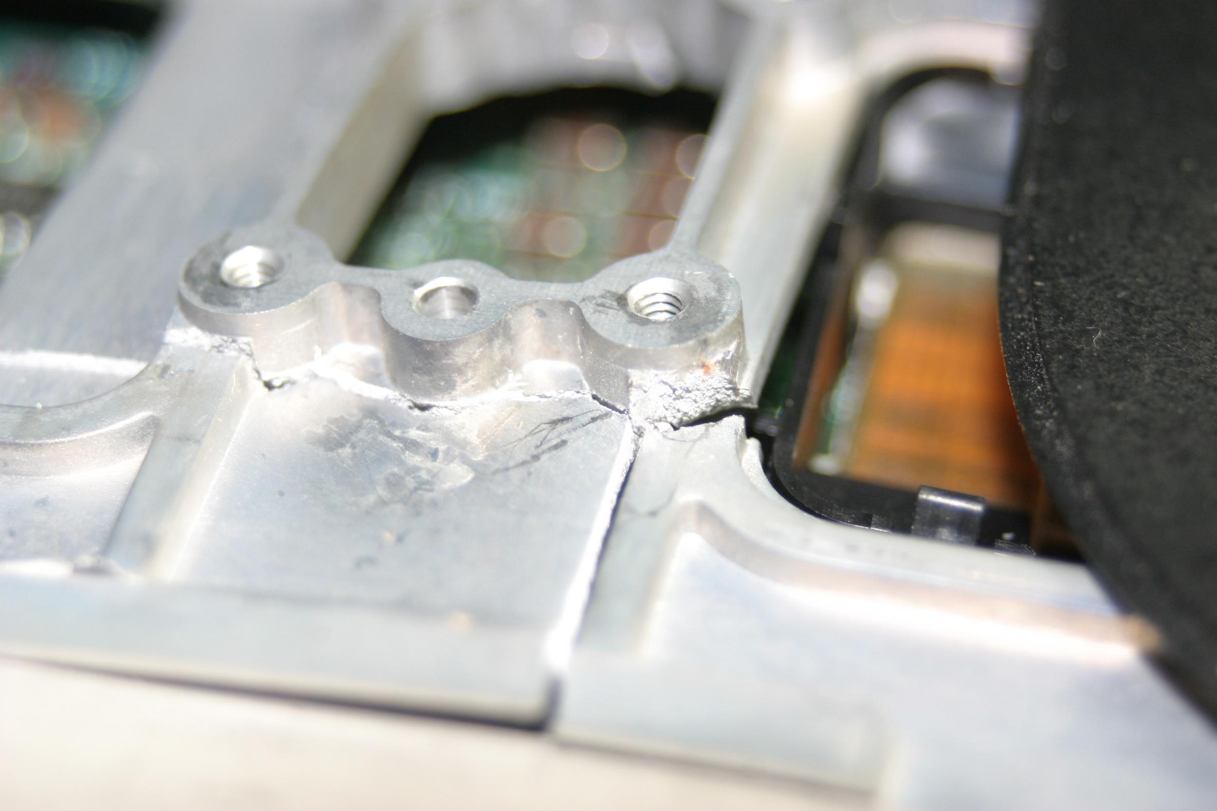

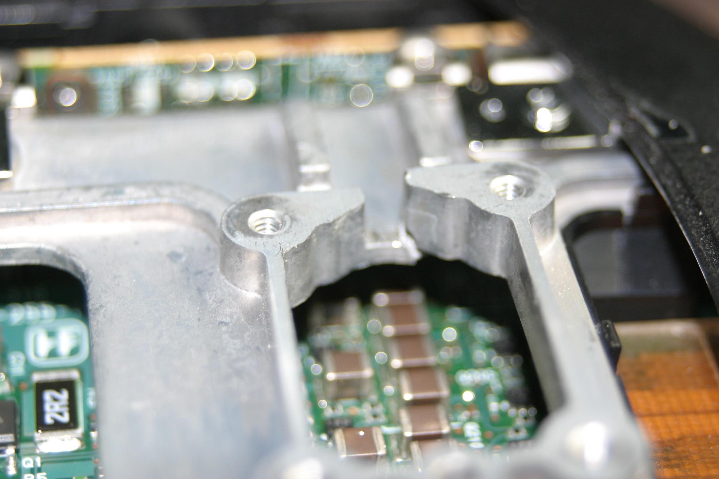

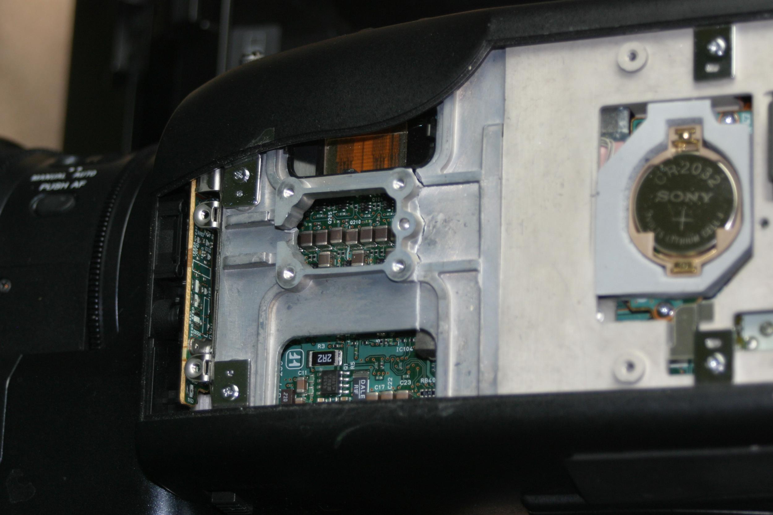

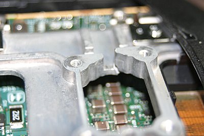

Does anyone know of a certified Sony repair center that works on Sony PMW-EX3 cameras? My EX3 camera base frame bracket where the tripod attaches was damaged when the camera and tripod were blown over onto a large rock while on location when a very strong whirlwind which suddenly appeared out of a blue sky. The camera works fine but the aluminum bracket in the base where the tripod mount attaches was broken. This may or may not be repairable. If you have any information or advice which would help me get the camera repaired I would appreciate it very much.

I am sending the camera to Sony Professional Services in LA.
The replacement part number for the lens frame is 178885113 and it cost $389.00 now add labor and shipping and the cost could run about $1000.00 for full repair.

The saga is finally over as the camera arrived back from repair this afternoon.
Labor 4 hrs @ $135 per hour = $540.00
Battery Case ASSY - $91.97
Mount Lens - $373.51
Bracket Tripod - $22.31
Handling - $20.00
Insurance - $25.00
Sub Total: $1072.79
Tax: $86.44
Total: $1159.23
TThe camera was upgraded to the latest version firmware V1.17
LAservice (Sony Electronics) was very professional and cordial. I would use them again in a heartbeat.
