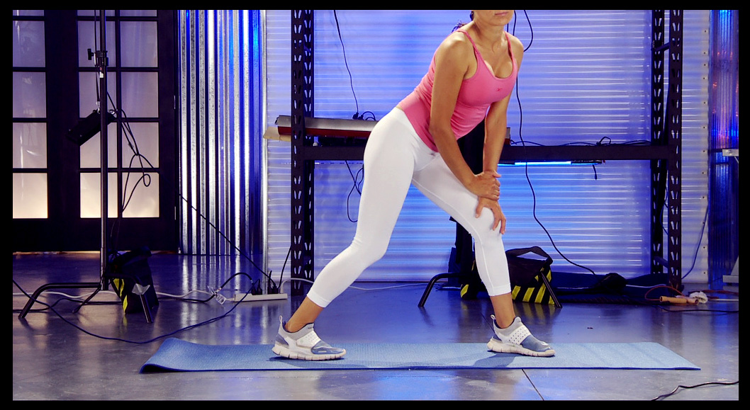

I'm working on a fitness program for Latin America. I'm having the hardest time getting my EX1Rs to look good on my Hispanic talent. I can't seem to get rid of the yellow in the skin tone. Here's some screen grabs shot during a rough lighting test during set construction.
Sequence 01.Still001 | Flickr - Photo Sharing!
Sequence 01.Still002 | Flickr - Photo Sharing!
Sequence 01.Still003 | Flickr - Photo Sharing!
I'm using fluorescent softboxes for key and fills at 5600K and some Coollights 5600K Fresnels for rims.
EX1 WB is set to 5600K. Picture Profile is "Standard" factory settings and just changed the matrix to FL Light, gama is set to CINE3 and skin tone detail is on at -40 intensity. I have a bunch of other picture profiles, but this seemed to get us the closest...
But we're still not close to satisfied, and I'm hoping you all can help me get more natural skin tone.

Thanks guys,
Hmm... I've tried every preset (I think) that's listed in the "recipes" forum on this site (http://www.dvinfo.net/forum/sony-xdc...e-recipes.html).
Vortex (Jensen's) seems to add a bit of green plus the yellow. It's far worse for this setup.
B. Raven's seems to be the best, but still yellow.
Wolfgang's messed with the detail too much, but the color was still off, but off in a different way.
Bloom's is similar to what I"m using.
Oliver N's makes her look dead.
I've used a lot of these presets for other situations fine, but for this studio setup, I can't seem to kick the yellow out of the shot and get it more healthy looking.
Any other suggestions would be appreciated.

Have you considered using some violet and pink gels on the key lights to kill some of the yellow?
With that strong blue background you will be making the natural yellows in their skin tones stand out.
You will want to kill that with some opposing color in the key (opposing to yellow = violet then add some pink.red to make them look more healthy).
Once you do that I expect you will be able to tweak the camera and make them look more healthy and less jaundiced.

Oh, yeah. Good idea on the gels. I have some old magenta gels around, so I'll give those a shot. I might have to get some less intense magenta, but I'll give it a go. Great suggestion. I will try it and post some pics back.

Ok, thanks to the gel suggestion by Chris, I'm making a lot of progress.
I happened to have some dark magenta gels from a previous project, so I slapped them on a 650w Fresnel and LED bank (my main key lights). Then opposite the key, I put another gel on my rim to the left/behind of the talent. The gels might be a bit too intense in the back, but it does add an artsy look... but it's a bit much for my taste.
I changed my PP to "A Ships. Cine V" and tweaked it a bit from there.

Any further suggestions?

Try doing a White balance with the blue background lights turned off. I suspect they may be your problem

The colours were easy to correct in Premiere, using RGB curves, just add more Magenta. Here is a screen grab which took less than 30 seconds to achieve.

Try using a blank picture profile with just the Matrix changed to FL-Light to get rid of the green/yellow cast from the fluorescent lamps (still present in many "pro" video lamps) or the Cinema Matrix for a more balanced look.
You can mix and match picture profile settings taking just the bits you need from each profile.

That is much better. Now they don't look sick. I personally like the little pop of magenta in the rim. Since you are using strong colors in the background you can blend them into the foreground with your colored backlight.
If you want to try a bit more you can play around with gels in the orange range of the color wheel on the key if you want to emphasize their tan more. Otherwise you are in good shape.
