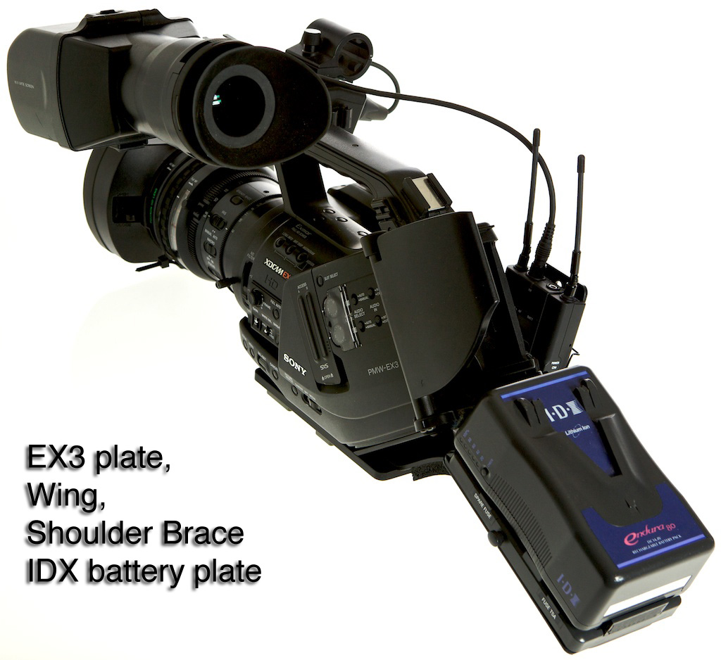

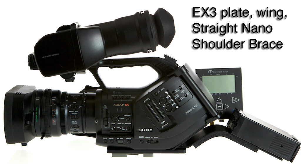

You may want to check out my solution:
EX 3 Tripod plate and Shoulder Brace Options
EX3 Users I need input -Exmount or ST7 mount ????-ex3tp-3.jpg   EX3 Users I need input -Exmount or ST7 mount ????-ex3tp-5.jpg

I can vouch for Olof's mount. It's pretty much a permanent installation on my EX-3. However; I did already have the IDX brick system, so it was an easy and cost effective transition

here's my support shoulder brace. The nanoflash is screwed on with a bracket on the back. Works for me!

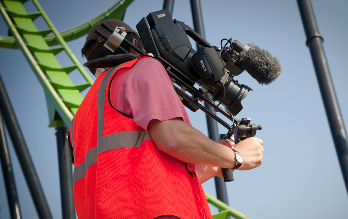

I've become a big fan of the Genus Rig. It's the first outfit that lets me shoulder mount and maintain balance and functionality. I also use the original batteries or Switek to run my Nano and the extra weight on the back just makes balance a breeze, even for long periods.
With the aid of Manfrotto zoom controller (the smallest I could find), I no longer have to remove my hand from the handles to start, stop or zoom the lens.
EX3 Users I need input -Exmount or ST7 mount ????-screen-shot-2011-12-05-10.22.59-pm.png
