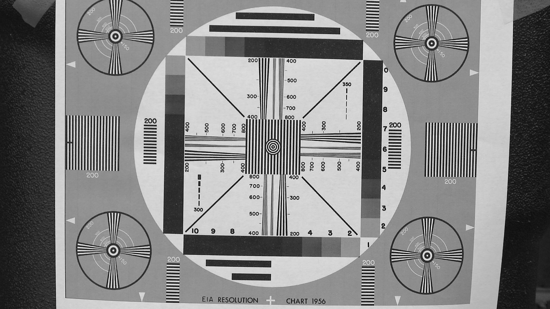

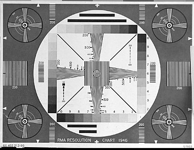

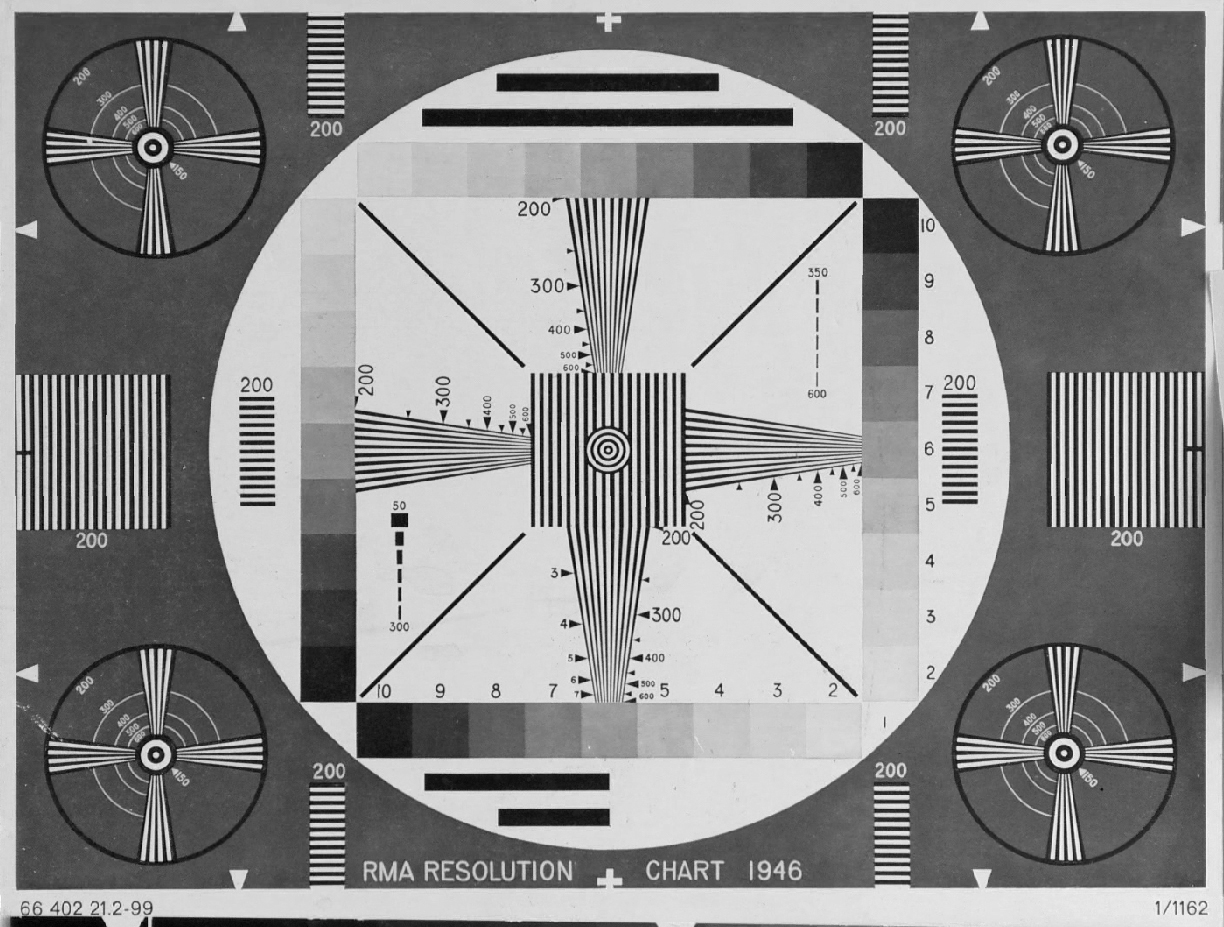

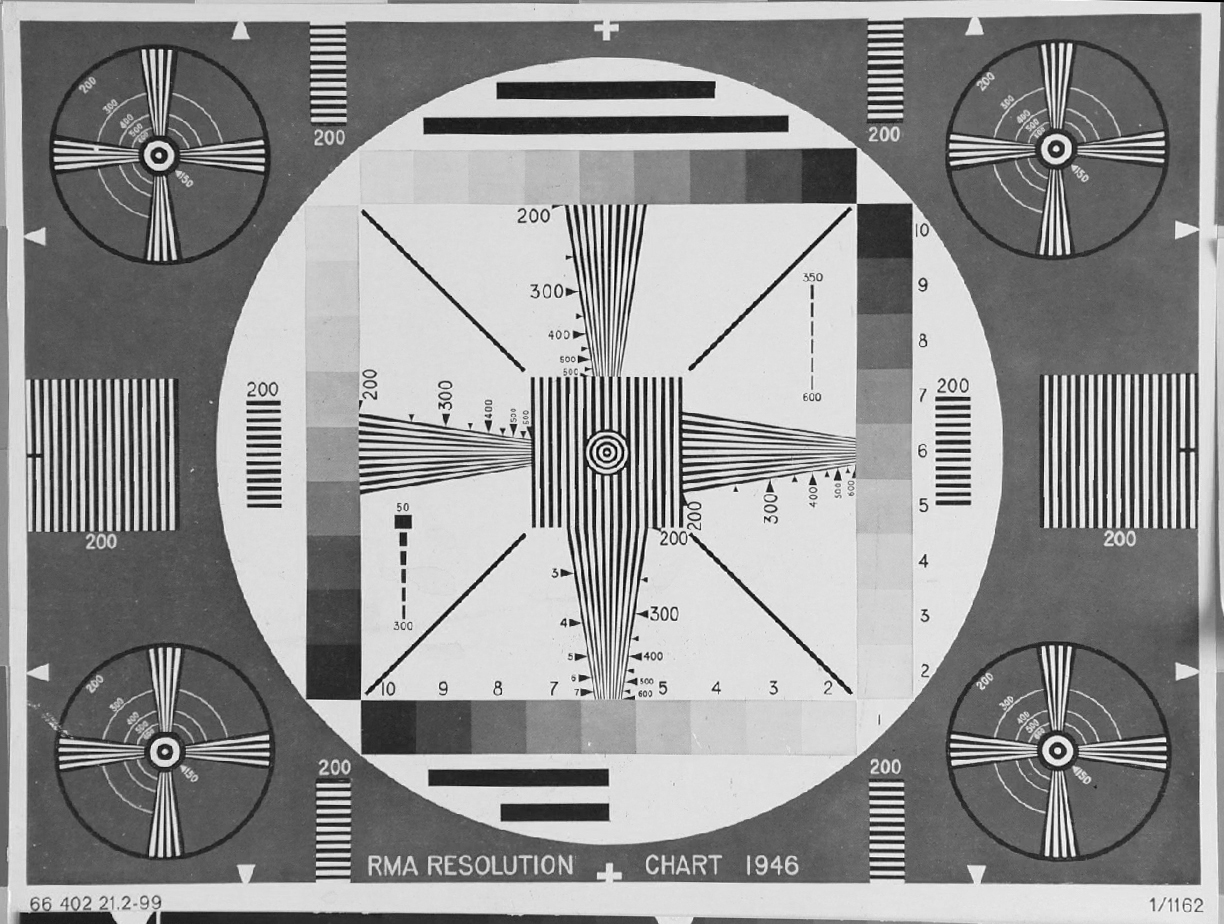

This might interest those with a Sony PMW-320: I made some comparison test shots for sharpness, with the three 1/2-inch Canon lenses that I have for this camera: YH19x6.7KRS (SD), YH16x7 KRS (SD), and KH10ex3.6 irse (HD).
Shots were made with aperture 4; focusing on a 42 inch monitor; zoom ratio different of course, because of the different focal lenghts; identical camera settings; screen grab from XDCAM browser; desaturated in Photoshop to concentrate on sharpness alone.
You'll notice that there is very little difference. In fact the minor difference in sharpness between the 3 lenses is overruled completely by even the smallest mistake in focusing. I focused on a 42 inch screen to get the ultimate precision, but when focusing with the 320’s viewfinder, it is virtually impossible to reach the precision that is needed to bring out the difference between these lenses. Of course, with scientific equipment that can actually measure sharpness, the differences will be more apparent (I presume)...
Half inch lenses compared-desat-10x-vlc-fullscreen.jpg   Half inch lenses compared-desat-16x-vlc-fullscreen.jpg

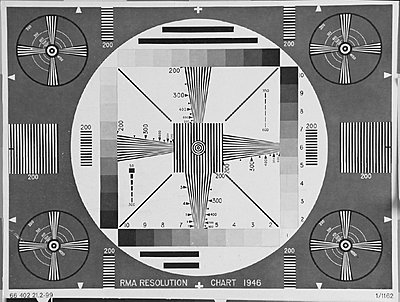

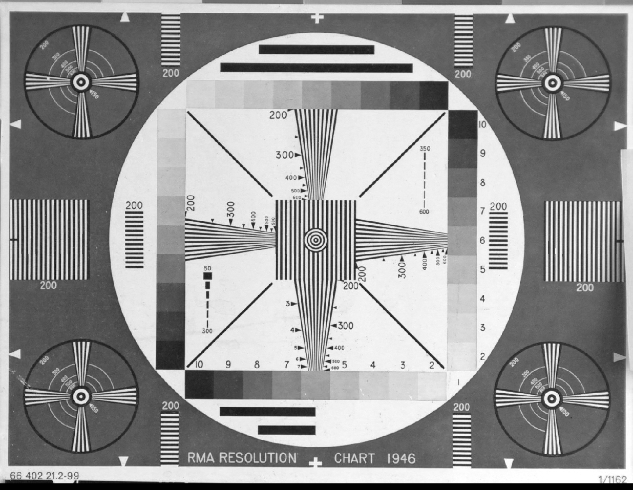

DV-member Jim has sent me a screen grab of a comparable chart, shot with the PMW-320 kit lens in comparable circumstances. Looks very sharp, too...

Afraid the chart I used is not very good so the contrast levels don't look right.
