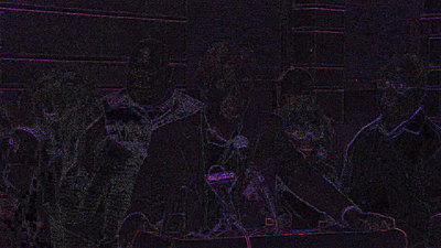

I agree with part of Doug's response - there isn't much noticeable difference to the eye between the 35Mb SxS and the nanoFlash's higher bitrates when using an EX1/3. However, recording 10bits isn't going to increase the ability to grade because the image already has quite a lot of noise, which is the limiting factor, not 8bits. I have tested recording uncompressed thru a Blackmagic Decklink Extreme 3D and then reduced noise with Neat Video and then exported to Cineform 422 (Film Scan 2 - highest setting). I also recorded to the nanoFlash at 280Mb I-frame, reduced noise with NV and exported to Cineform with the same settings. I also did the conversions to Cineform without reducing noise and the file sizes were 3-4 times as large due to all of the noise. (with a 12-core PC, it took 12mins of rendering time per 1 minute of video to render from Premiere Pro CS5 using Neat Video)
So, I then brought these files into After Effects and graded in 32bpc mode and every time, the limiting factor was noise. However, the noise reduced images had far more ability to be pushed and altered than any of the 10bit & 8bit source files.
Personally, I only use my nanoFlash with my EX3 (or EX1) for a backup recording or for very long record times. Although, I am testing it with a FS100 where dual CF slots and MPEG2 format provide significant advantages to the single internal SD card & H264 recording.
Side note: just in case you are considering the IDX V-mount adapter plate for the EX3, be aware that it blocks the rear shoe and requires some modifications in order to un-block the rear shoe.
Attached are stills from an event last year of the SxS and 100Mb L-GOP nanoFlash as well as a jpeg from Photoshop where I layered the SxS over the nanoFlash and set the SxS image to Difference and then used Levels to make the difference easier to see. I also included JPEGs to make it easier to see the originals if you don't want to download the TIFFs. Btw, I just noticed that the SxS JPEG is only 823KB whereas the nanoFlash's JPEG is 1.00MB. This tells you that there is more information recorded in the nanoFlash's image.

I don't agree with Doug on this at all. There is a huge difference between a NanoFlash at 80Mb/s or higher and an EX at 35Mb/s. Like wise between the EX and a Samurai.
As Jack has already said if you want to sell your footage to broadcasters, 50Mb/s plus will widen your possible market no end. Also being able to offer "broadcast quality" may help you differentiate your clips from all the home video clips out there.
Going to 80Mb/s and above on the NanoFlash will lead to much reduced quantisation noise and less macro blocking. If you shoot a big wide static shot then I doubt you see this on a moderate sized TV. But if you have moving objects in your shot then the situation can change very quickly. Something like an erupting geyser with lots of random motion or rippling water can cause the 35Mb/s of the EX cameras to degrade noticeably. Initially the EX codec will deal with this by throwing away more data and the image will soften slightly, which might not be obvious to the viewer, but there comes a point where it just can't cope and as well as the softening you get a lot of additional mosquito/quantisation noise, which will limit how much you can grade the image. This usually shows up as banding on evenly illuminated parts of the image, things like the sky or wall and is often blamed on 8 bit recordings which is very often nothing to do with the problem.
Recording to an external recorder at a higher bit rate, whether a NanoFlash or Samurai will reduce or eliminate these issues. But, the EX3 is quite a noisy camera. The noise level is higher than the sample size of an 8 bit recorder, so an 8 bit recorder is capable of sampling all the real detail and brightness levels from the camera. All going to 10 bit does is create bigger files, it does not give you any significant grading advantage when the noise floor is as high as it is on an EX. This has been discussed on these boards many times and research by the EBU and others (European Broadcasting Union) bears this out. The EBU stating that with most current cameras there is no advantage to be gained from shooting 10 bit for the majority of productions. With a less noisy camera, then 10 bit becomes clearly advantageous and cameras like the F3 can really benefit from a 10 bit recorder, but that's not the case here. The EX's noise levels will limit how far you can push it in post long before any differences between a 10 bit or 8 bit recording become apparent.
For an idea of what can happen to the 35Mb/s EX codec take a look at the images here: This is why you want an external recorder! | XDCAM-USER.COM
Done with a Samurai, but a NanoFlash at 80Mb/s or higher will bring an almost identical reduction in the mosquito noise (all the fuzzy lines around the branches). It looks like a little swarm of mosquitos buzzing around in the branches in the video. I used to have a similar example comparing a Sony PDW-700 (at 50Mb/s) and a NanoFlash at 100Mb/s on my site, but lost that when I had a server drive failure last year.
