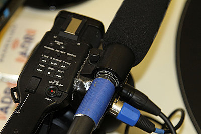

Hi Daniel,
Since the day the mic-holder of my EX1R broke for the first time I just secured it with a piece of tape (picture enclosed). I'm just not willing to spend some $100 on a stupid piece of plastic and have had no issues since.
Gabor
