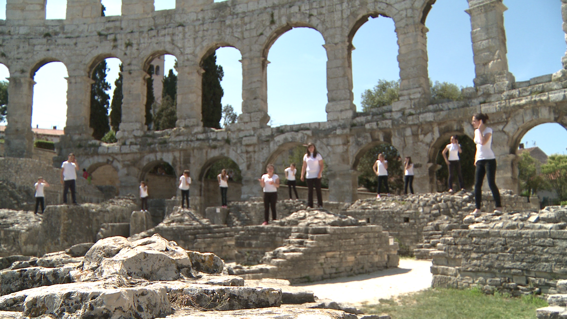

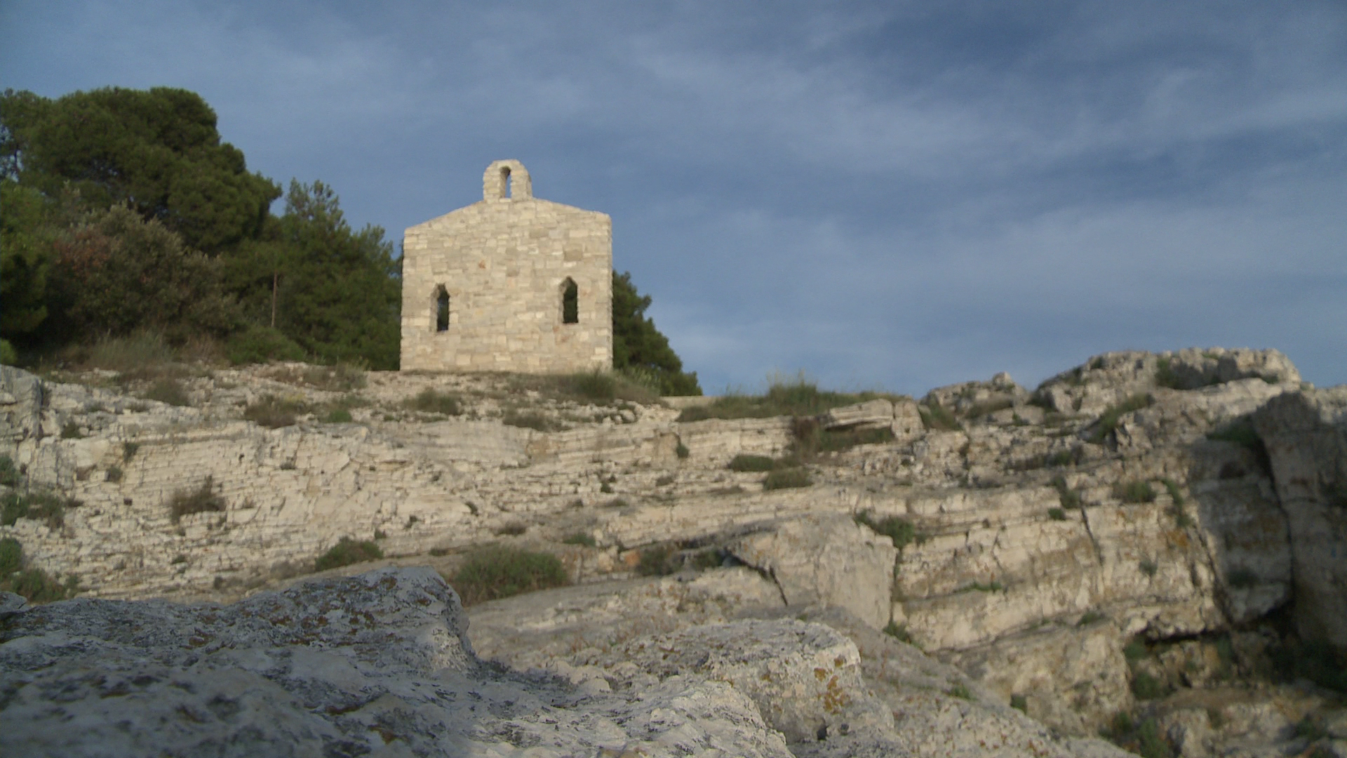

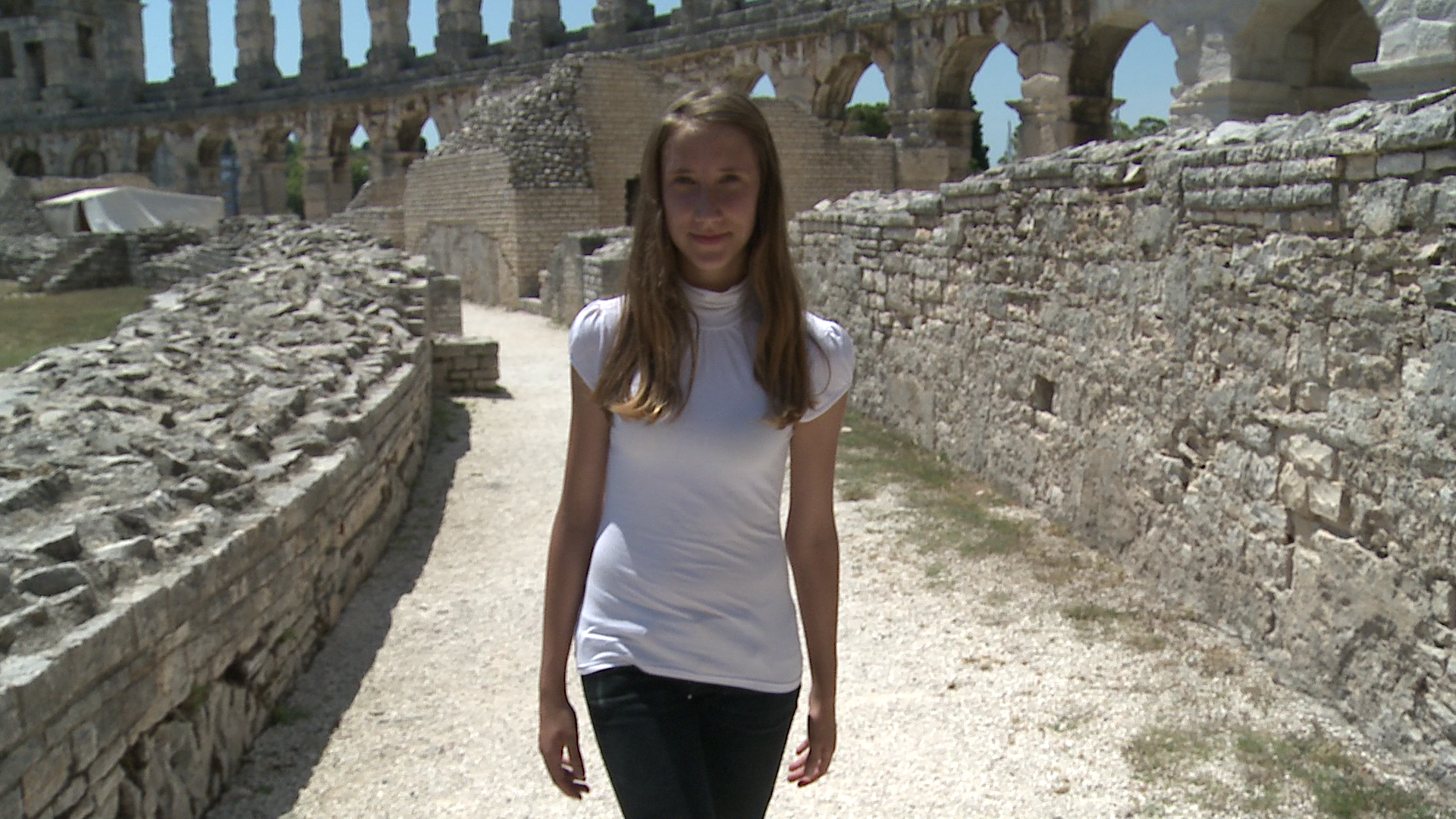

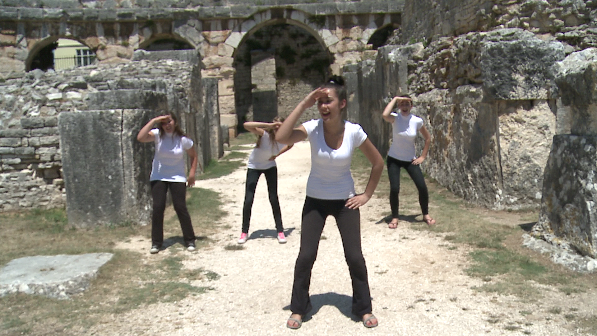

We have been shooting some music videos in the last days, and had a problem with focus. We used two EX1 and one EX3, and sometimes it wasn`t possible to fully focus the shot. I turned on peaking, and shot at its maximum, then when we put the footage on big screen, we saw the problem. It was even possible to see on small camera LCD that it is not fully focused. I checked several times that macro is turned off.
I`m trying to think if it is because of high temperature, as we were shooting at around noon, with temperature around 30-40 celsius?
I have attached few frame grabs from ClipBrowser so that you can see what I am talking about..
Does anyone had a similar problem? How can it be fixed?
Thanks for help

Could be in need of resetting the back-focus: http://www.dvinfo.net/forum/sony-xdc...ml#post1524295

Yup, backfocus, you can see clearly in the first screengrab that it is shifted forward. Do the procedure and everything will be fine.

Start with your EX3 because that is much easier to access the backfocus menu. Go into "LENS > Auto FB ADJ" to do the auto backfocus. For your EX1s, you'll have to gain access to your Maintenance Menu in order to do an auto backfocus.

Thanks for very quick help..I have adjusted the back focus now. Some people say that it drifts away with some time..

Back focus certainly could have caused this issue, but as you were in direct sunlight at noon, is it possible that your exposures were beyond 5.6? The EX1/3 lens image quickly begins to fall apart beyond that point. f/6.7 might pass, but if you are down at f/11 or f/16 chances are you will get images this soft.
