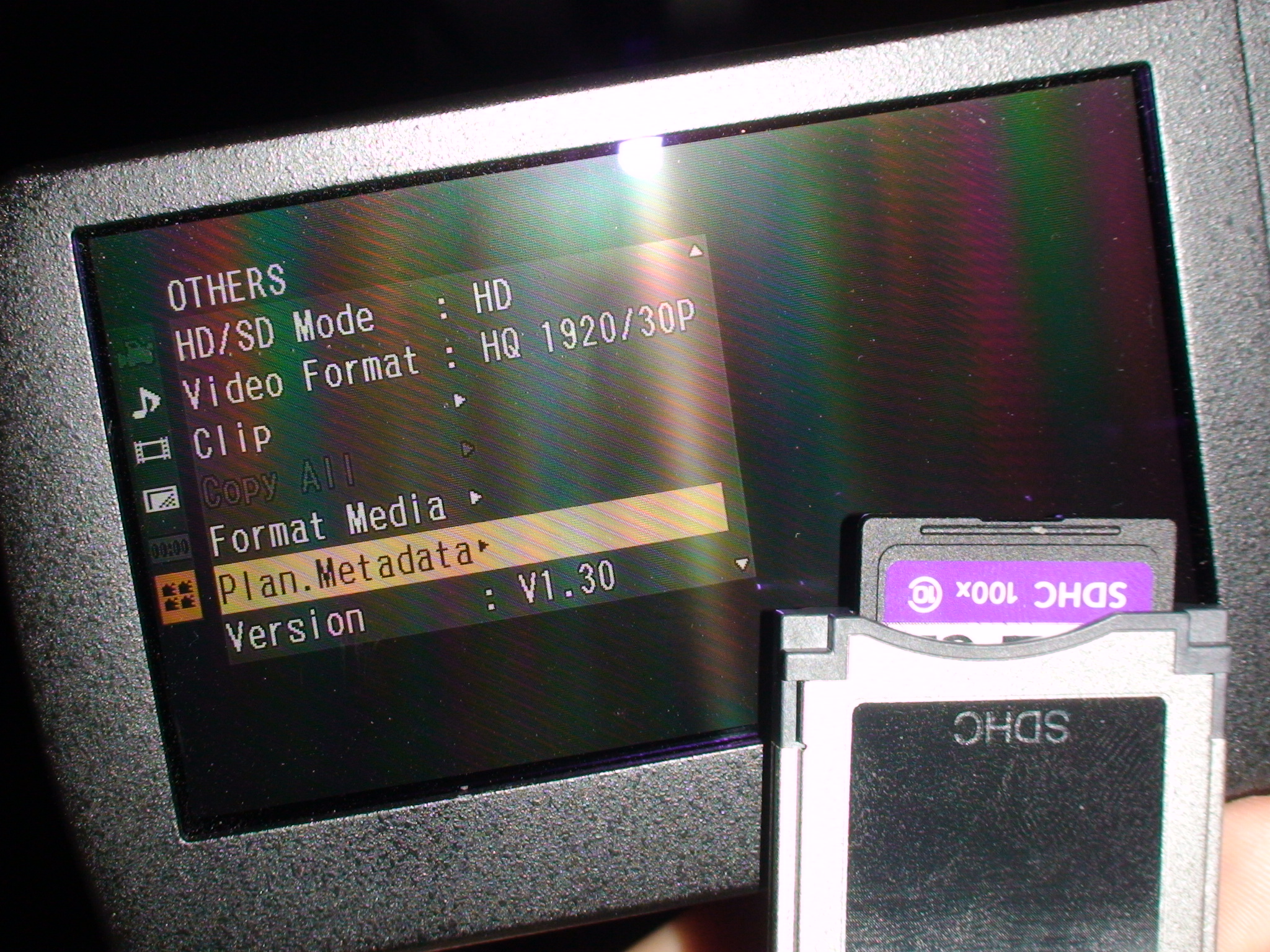

Double posting cause I managed to get it to get the update to work on a SDHC card.
Clip Browser 2.6 still works. Overcrank still works. I'm extremely happy.
Protip: To make updates work via SDHC, you need the Sony SDHC adapter and you have to put the update .BIN file in the SONY folder. There should be a BPAV folder and the update .BIN file in the SONY folder once you're done.
I've attached photo proof.
