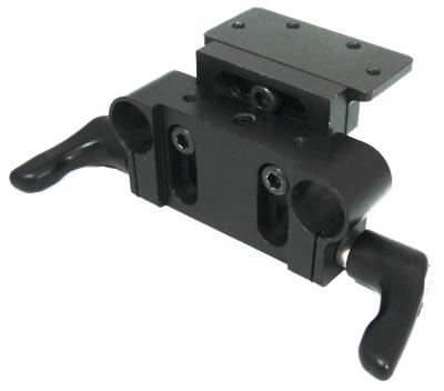

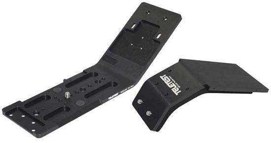

I saw both plates when I was looking to buy a year ago.
What made the difference for me was the VF Gadget plate was a single piece of metal instead of two pieces welded together.
Plus they now make a 15mm rod clamp which fits into existing holes in the plate.
Both offer the add-on shoulder piece for additional stability and possible battery mounting.

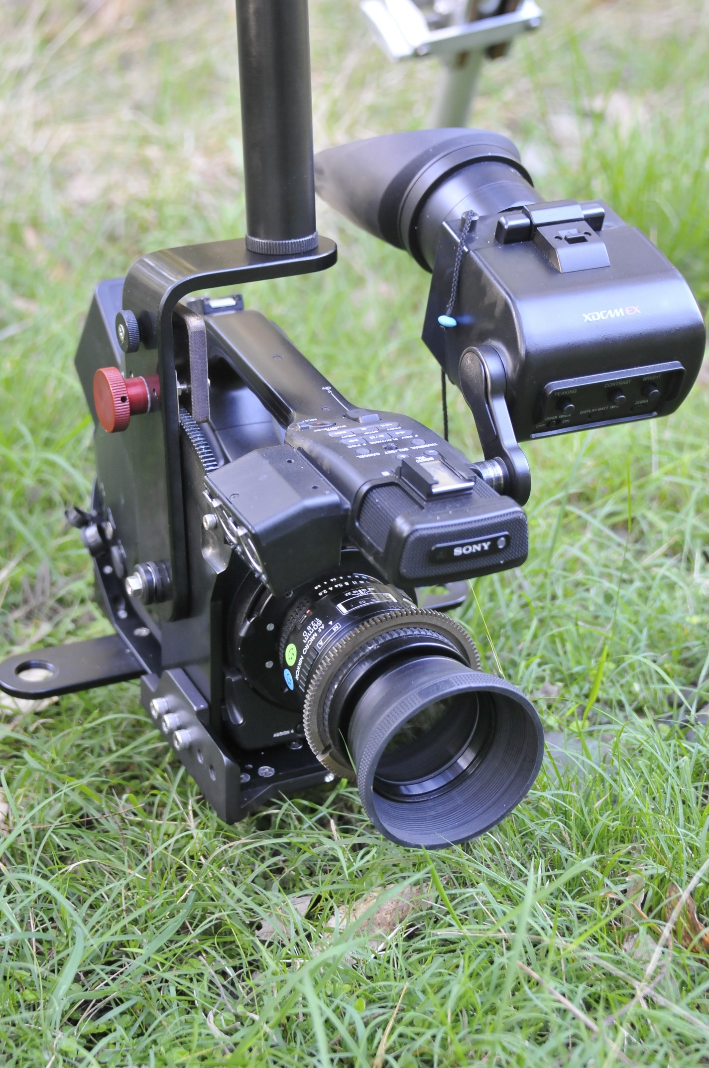

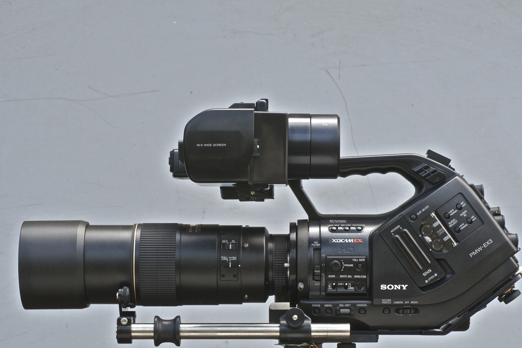

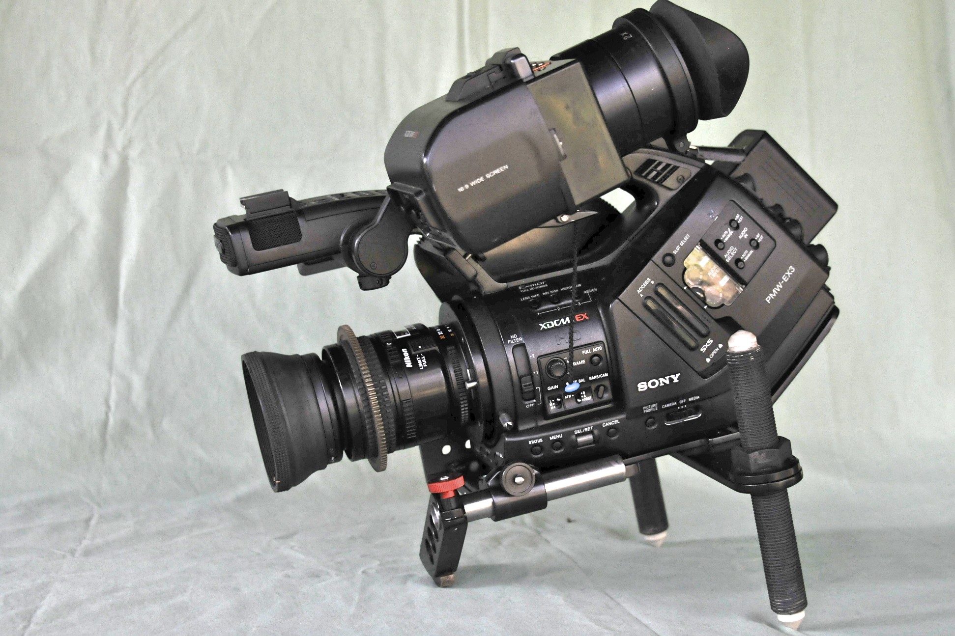

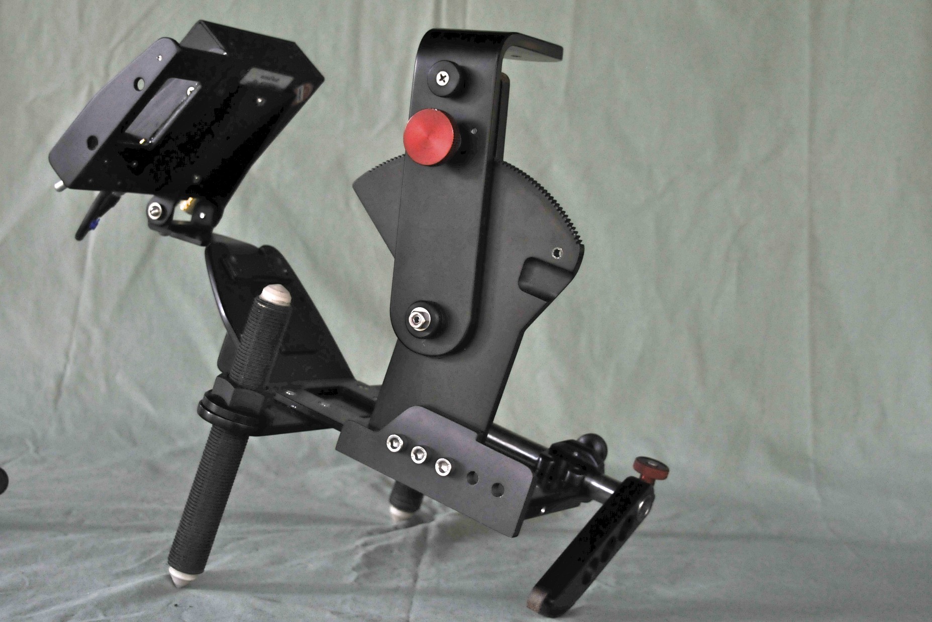

A base plate for the EX3 is an essential accessory for tripod work and it also a good mounting point for other bits and pieces..
I have a single bar that is used for a rocker style lens support or as a wrist kindly grip for hand holding. As its axis is parallel to the lens axis it can also be used as a sighting device when using long prime lenses.
A hinged tongue on my nanoFlash snaps into a matching slot on the base plate.
I am interested in low-level close-up shots and have found that a simple mini tripod built into the base plate can be quick and easy to set up for static shots. In the version shown a quick tilt adjustment can be made with the front leg that utilizes the lens support mount clamp. Fine adjustments are made by rotating the threaded legs.
To further facilitate low-level shots I am experimenting with suspending the camera from above to eliminate anything between the base plate and the ground. The vertical fan shaped bracket has spur gear teeth cut into its upper edge, these teeth engage with those on the red knob’s shaft. Turning the red knob adjusts tilt. It is likely to be motorized and/or fluid damped in the near future.
