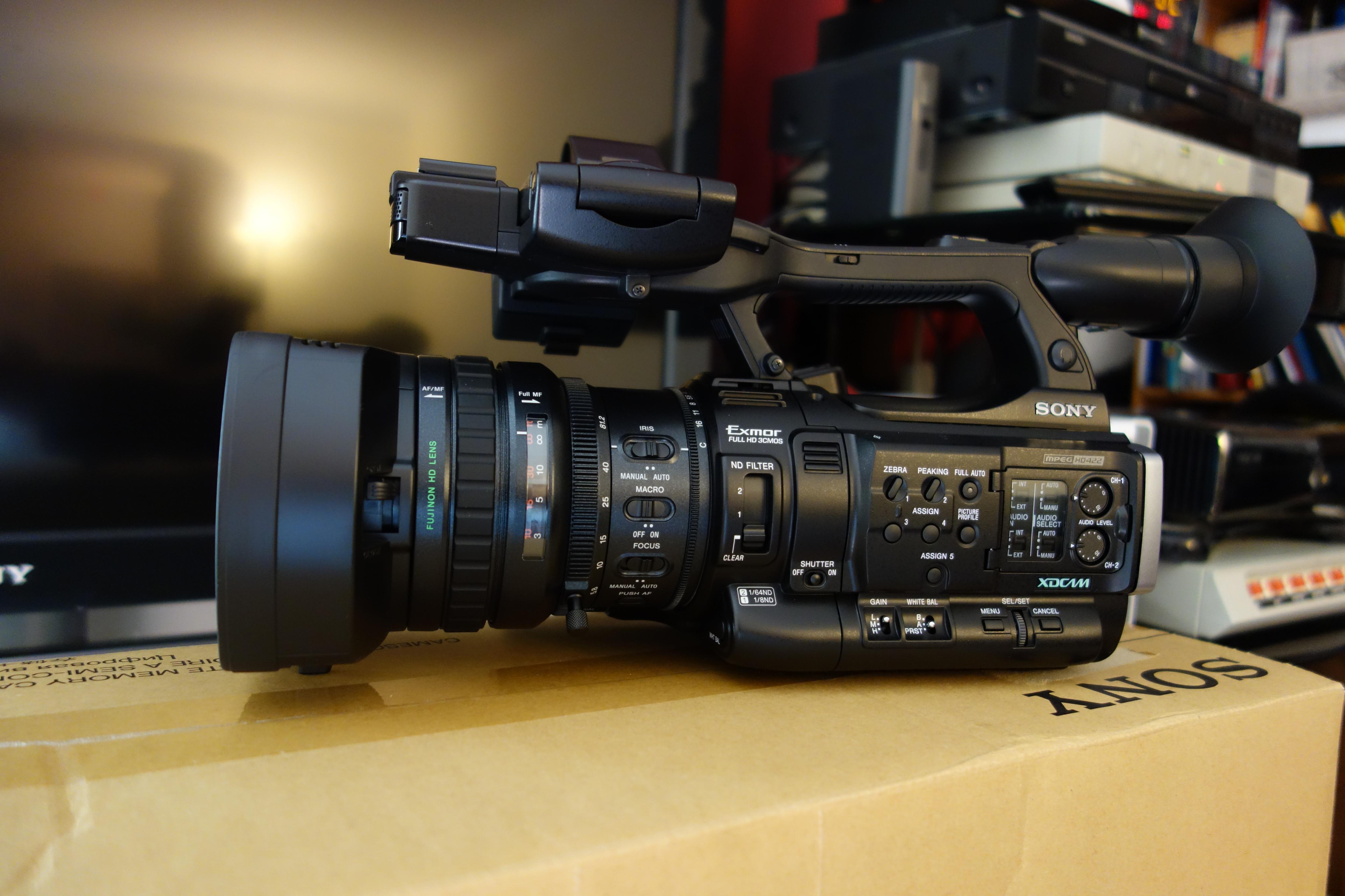

Old October 5th, 2012, 02:10 PM   #15
Location: New York City
Posts: 37
Re: So I bought PMW200. Now what?
I am planning to go to Central Park, weather permitting to test this baby out.
Meanwhile its sitting in my living room.
