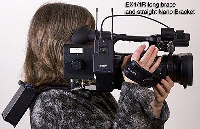

You may want to try my shoulder kit. It works well and is very affordable, it can be used with AB or IDX style batteries. It also makes the base much stronger.
EX1 Tripod plate

I've had the pleasure of using Olof's shoulder mount for the EX1r and now the EX3... I was coming from years of using shoulder mount cameras (mostly Sony's DSR300s, 570s, etc...). Hand holding the EX1r and even the psuedo shoulder-able EX3 are very trying past about 10 mins... With the shoulder mount system, Olof configured me with a quick release Sony adapter for my tripod's VCT Sony tripod plate (from my DSR camera days) and an Anton Bauer quick release battery adapter that sits to the rear of the shoulder mount. I can go about 20 mins, before needing a break...
I use the Dtap on the shoulder rig to power my light, Nano Flash, or wireless receiver. The Anton batteries also power the camera, but I still keep the Sony battery snapped into the camera just in case I accidentally disconnect the power cable from the Anton Bauer/Shoulder mount rig. I hear that losing power while recording can result in possibly losing your entire clip. Keeping the Sony battery on board also allows me to hot swap out my Anton Bauer batteries (Dionics) without having to power down and then power up the camera. That has saved my a$$ on a few ocassions, when recording long conferences or toasts!
I also have an adapter accessory plate on my rig that easily holds a Nano Flash or a 2nd wireless receiver. I velcro my primary wireless receiver to the Anton Bauer battery as the additional rear weight helps to better balance the rig.
Here is a comfort hand held rating for comparison:
EX1r without rig: 5/10
EX1r with rig: 7.5/10
EX3 without rig: 6/10
EX3 with rig: 8/10
DSR 390/570 shoulder mountable camera: 9/10
I shoot a lot of weddings and Bar/Bat Mitzvahs, so I'm handheld almost all the time (during the reception).
With the quick release plate adapter, pulling the camera on and off a tripod is about the same as my old DSR cameras, however, being able to hot swap out the batteries without powering down the camera, gives my current rig a distinct advantage...
I switched to the EX3 (from the EX1r) because I can use my old 1/2 lenses for additional reach. I do, however, miss the Ex1r's hdmi video out...
Hope this helps!
