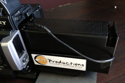

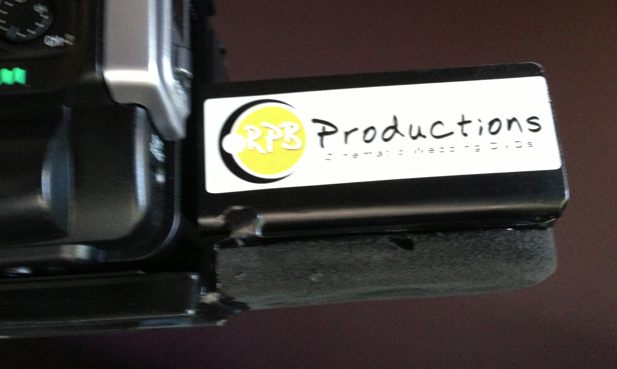

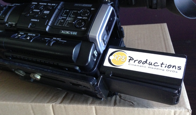

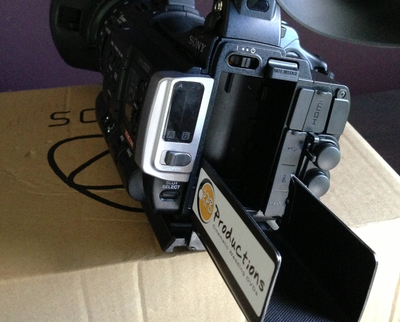

Hi, i have just worked out how to mount a non Genuine Battery a PMW200, I had a small mount made and it was fixed to the tripod to The Tripod Plate, you can click the battery into the camera as you will get a batty error, buy if you lug i the small cable first, then put the battery in upside down with a small amount velcro holding it in place your good to go, and you can also use the d-tap plugs.

A strap and velcro might be more secure. (heck, you could even use rubber bands)
Hopefully a rig creator (like Westside AV) can find a way to use this design in an actual tripod plate that can be sold.

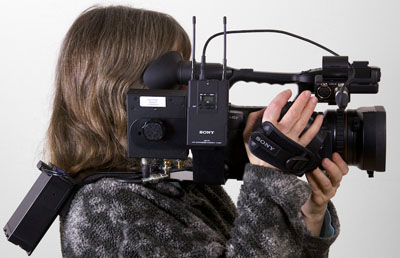

I think you could just velcro the battery to my EX1R shoulder brace. I also use o-rings around the battery to make it rock solid.
Those batteries always worked on the EX1/3 cams if you plugged the cable in and turned the camera on after. I think someone else mentioned this as well.
EX1R Tripod Plate and Shoulder Brace Options
The photo shows a Swit with lengthened cable powering an EX1R and the Nanoflash from the D-tap. I realize you don't need the NF any more with the 422 internal, but it will powe an on cam light or whatever.

update, have had it out for 3 days now, love it the extra battery mound make it easy it sit on your shoulder .
